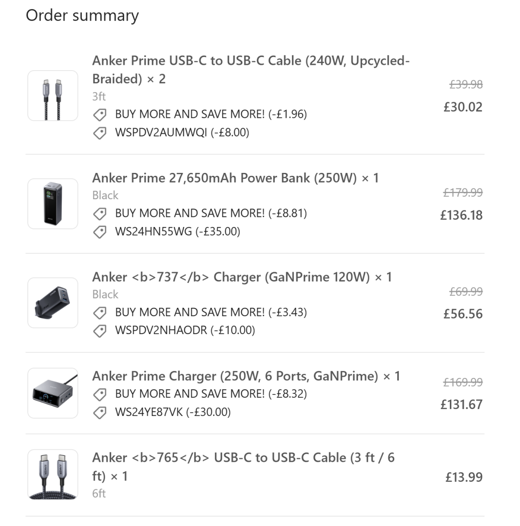

Posts: 14293
Been wanting a decent charger and powerbank, so placed an order with Anker off the back of this thread. Already have one of their big 1000Wh powerbanks in my truck
Posted : 25/04/2025 7:32 am
Posts: 833
27,650mAh and 660g, that’s a monster and hefty for bike packing!
Interestingly my ancient Goldmans 10,000mAh weighs 220g, so the technology hasn’t changed much. I am unsure what the charge/discharge rates of the Goodmans is and it’s suitability for bike packing.
Posted : 25/04/2025 7:55 am

Posts: 14293
Posted by: nickingsley
Should have stated, mine aren't for bikepacking
Posted : 25/04/2025 9:01 am
