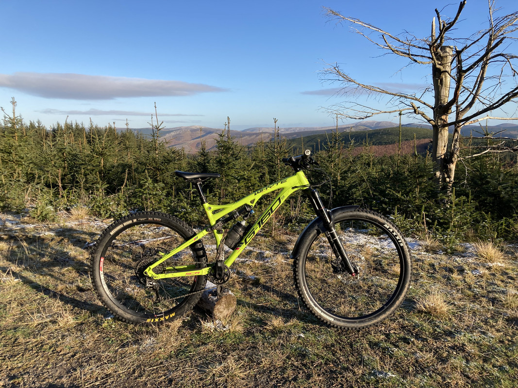

Specialized Status for about 6 months.
At 5'9" I think it works well for me.
I ride in Aberdeenshire where the trails are mostly fireroad up and enduro type trails going down.
It's probably a little too slack and low for these trails, even in its high setting and the back end really can't keep up with the front, I've improved this slightly by getting rid of the boat anchor NX cassette and reducing the size of the spacer in the shock.
I'm not the greatest rider, but this thing has me manualing out of corners and actually jumping stuff.
I'd definitely by another that was maybe a little less like a park bike and a little more refined.
Posted : 11/02/2021 9:00 pm

Posts: 6980
Thought I’d bring this thread back from the dead after having a bit of fun yesterday. Behold the mulleted G160
Managed to get a really good mix of trails in on it yesterday, and struggling to find a situation that didn’t seem a bit better. The fork wasn’t ideal (older dual position Lyrik RC with a 51mm offset) but even then the front end felt really good, I think a 44 offset would calm the steering a bit further though
Head angle is hovering between 63 and 64 degrees
BB drop should be around 34mm from the front axle
The fork is a loaner so mine will be going back on shortly, definitely giving me food for thought though
