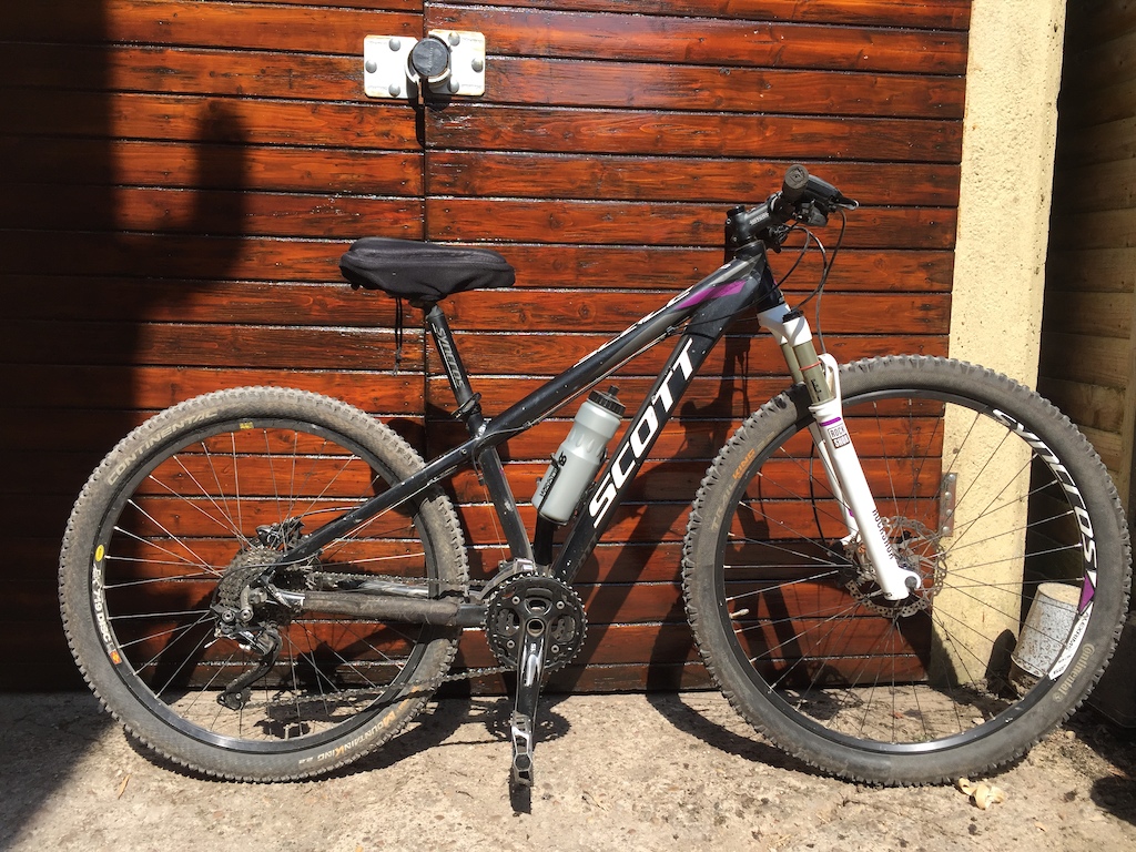

I went for a reverse mullet on my wifes bike. Swapped the 29" at the back for a 26".
Positives
Lower BB
More seat post extension so more power
Slacker head angle
Negatives
Very low BB, If she rides it off road she will probably catch her pedals a lot.
Slacker seat angle.
So far she likes it. I can always put the old wheel back in if she changes her mind.
If you put a 26" fork on, could you put a shorter axel to crown one to minimise the changes?
You would make the head and seat angle slacker plus raise the bb.

Posts: 3438
Hi,
The smaller wheel lowered the bb.
My wife can move the saddle up by that amount and still touch the floor. The saddle height was set so she was confident she could put her feet down, not for correct leg extension.
She gets more power as she is closer to getting the saddle height correct for pedalling now.
