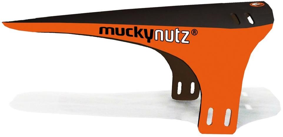

Posts: 36
oddly enough all those tubes on mine seem to act as a splatter guard anyway 🙂
But Id put one of those little enduro plastic guards under the brace and ziptie to the rear legs.
Posted : 27/09/2016 9:54 am

 kcal
Posts: 5448
also feasible to fit a little guard across the forks, to stop the spray that gets thrown up along the tyre and then towards your face. there are pre-made ones or an inner tube will do the task equally well..
