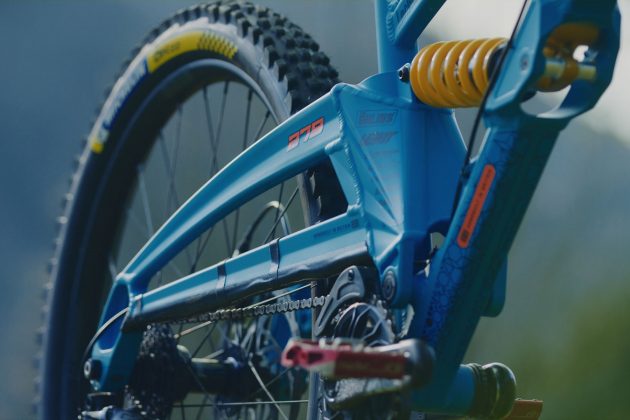

Posts: 3205
Exposed shock mount through hole in the downtube
orange 279
