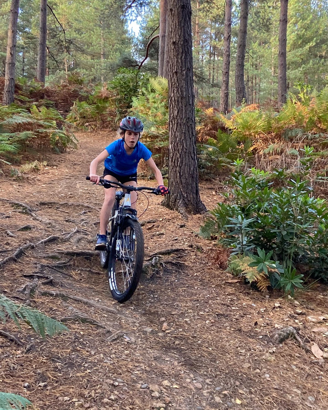

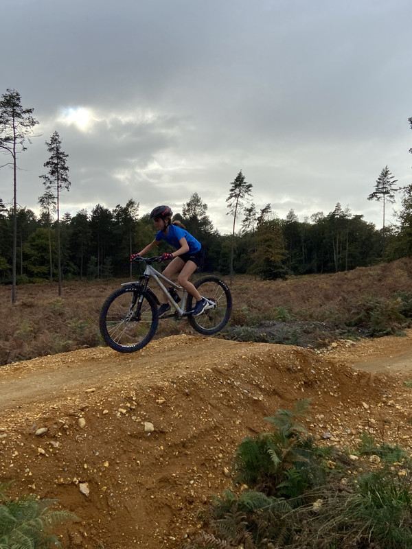

So my elder daughter (9 1/2) is looking rather tall on her Isla Beinn 24 and I’m wondering what the next step up is. She’s about 140cm / 4’7” tall, 71cm / 28” leg and various companies seem to put that on the cusp of 26” and 27.5” wheels.
I’ve got quite a lot of parts from my old 27.5” 150mm hardtail (the frame is clearly too big for her). Can shorten the fork and could rebuild a (rear?) wheel as 26” for a mini mullet. I realise that her legs are already as long as some adults’ but I’m so puzzled about the reach/ETT for someone her height - if I had to guess I expect she’ll end up 5’7”+ so whatever size she’s going onto next is unlikely to fit her in her teens.
