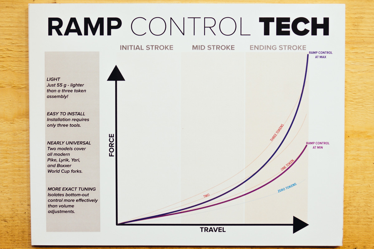

[img] ?1472690140/[/img]
From VitalMTB.com article
Posted : 02/09/2016 12:47 pm
Ha, was just going to post that. Nice and clear whats going on. Interesting challenge tuning that along with the damping too.
Posted : 02/09/2016 12:53 pm
Of course what this doesn't do is provide more support the whole way through travel. I have 3 tokens in my 29er Pike so I can keep it soft for initial sensitivity but not blow past the mid travel, bottom out is obviously firmer because of this. According to that graph with a RAMP id lose the mid support but keep the firm bottom out.
Posted : 02/09/2016 1:01 pm

Rockshox standard suggestion for a 130mm 29er Pike is for 3, and this is the same for all of the shorter travel versions of adjustable travel forks. Guess the MRP ramp is only for the full enduroists 😉
[img] ?1434510460[/img]

So for a given PSI, according to that graph, it does affect the midstroke chief, but to a lesser degree than tokems? I actually quite like that, as it would possibly keep the shock more supple on roots. Linear to highly progressive in the last bit of travel is how the WRC cars are setup, I believe. If it genuinely doesn't affect high shaft velocities in the mid stroke of the fork - then ut looks like an awesome idea.
I'd like to see a graph that takes into accountboth shaft speed and force, I'm probably being really thick but I could see the fork choking on fast mid sized hits - if it's purely speed dependant. Unless what they mean by speed dependant is actually force dependant.
Posted : 02/09/2016 1:55 pm

I'd like to see a graph that takes into account both shaft speed and force, I'm probably being really thick but I could see the fork choking on fast mid sized hits - if it's purely speed dependant. Unless what they mean by speed dependant is actually force dependant.
Sounds speed dependant, as in how fast air can flow through a tiny hole. It looks like it does apply at the mid stroke slightly as the max line is the device applied. At 1/2 travel any high speed hit would compress the air in the main chamber but that air couldn't then get into the ramp chamber quick enough, so you get the effect of tokens applied.
I think the slow speed version of the graph is just the min line, as in its not applied because the hole for the air is so big youd have to hit the fork faster then you ever would to get any restriction to the flow. Of course as the device take up some space it still follows the 1 token curve.
My take anyway.
Posted : 02/09/2016 2:31 pm
