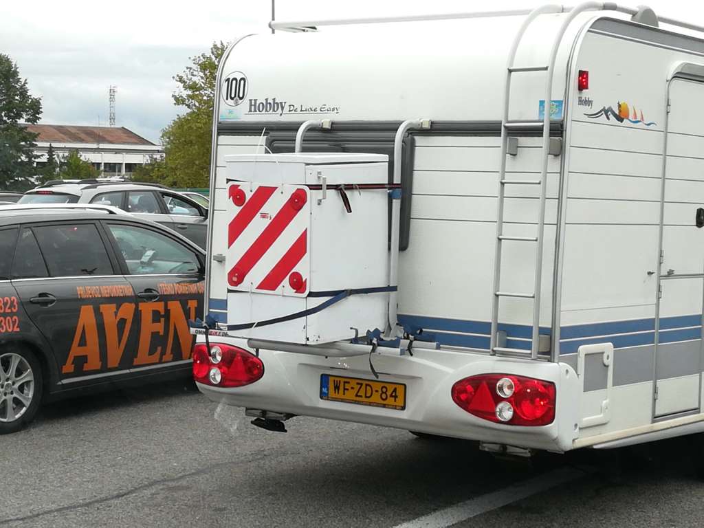

Posts: 14410
Just make sure that you have enough room for extra beers
IMG_20170915_131041
Posted : 02/12/2024 2:20 pm
