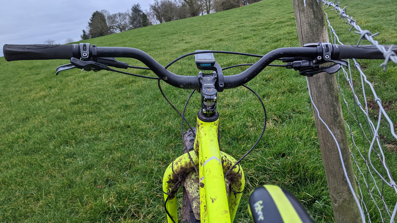

Hi. I'm currently running Cotic's Calver bars on my Solaris. They are 780 wide, 5 degrees up and 9 back, with 25mm rise. I am finding that I'm getting a little bit of ache in my hands after riding for a while and I wonder if I could do with a bar with more rise and/or sweep? All spacers are under the stem and I'm running DMR Deathgrips (which I've used for years.)
Being frugal at the minute means I can't buy several bars or grips to see what works sadly, so I was wondering about something like a nUkeproof bar with 38mm of rise. Or would it be worth jumpimg to something with 50mm? I ride mainly local trails and FoD, and nothing vaguely extreme!

I made the move from 30mm RF carbon, to 38mm then 50mm Burgtec Ride Highs in an effort to manage similar, worked for me. There's a few pairs of the Burgtecs knocking about 2nd hand that you could try, It's a 50/50 if you step to 38mm or leap to 50mm that it'll pay off. I guess being open to the increase in height might require a change to your riding style to ensure the front wheel is suitably weighted.
For context I'm on a XL 29er and 6'3.

This is all very interesting. I think I might try a 50mm rise and see how it feels. Any recommendations for decent bars at a reasonable price? I've seen some Spank ones. If I could get Renthal for sensible-ish money that would be evn better 🙂

So the Spank bars are 40 or 60mm rise it seems. Is 60mm going to be a rise too far?

How tall are you? What’s your saddle height? What size is the Solaris, which version and how long is the fork?

I'm about 183cm, in proportion(!), bike is a Solaris Max 2020 in L. Forks are Cane Creek Helm mk2 at 130mm.

@rstephenson What sweep did you go for? 12°?
Posted : 05/02/2023 8:18 am
Yeah 12. I'd be interested in trying the 16 out of interest but that does feel a bit more experimental. I still run a few spacers under my stem to get the height I want. I'm 183 on a large Solaris max too.
Posted : 05/02/2023 9:48 am

I ordered some of the Sqlabs in 45mm rise, 12° sweep. They should come this week. I also ordered some Ergon GE1 Evo grips, which do look like they'll be more comfortable than the Deathgrips. More news once it's all fitted and had a test ride or two.

“Low bars fells like you’re being pulled forward and you’re holding yourself up, you’re fixed in that position. With high bars, it feels like you’ve got more ability to push on the bars when you want as well as being able to move your bike about more.”
Yes! And this too:
“You dont need a low bar to weight the front of the bike because when you’re descending or going fast or otherwise attacking a trail, you’re standing up. You can put your weight wherever you want.”
And you have more leverage to lift / unweight the front.

Posts: 203
Ordered the Sqlab (how are we saying that? Ess Cue Lab? Sklab?) from Tweeks Cycles on the 7th. Website said due in for despatch in 7 days, which would have been last Monday (13th). On Monday Tweeks website said due in for despatch in 46 days...
So I phoned Tweeks, and after waiting for 10 minutes as caller number 1 finally spoke to someone. They checked and said the stock was in but they were not sure why it hadn't yet been shipped. I asked why it was now showing as 46 days, and was told that was for bars ordered after mine. Hmm. Four days later I've still not heard anything, no shipping email, nada. So I call up again, 10 minutes as caller number 1 to be told "they haven't come in after all. We don't know why. We'll have to check with purchasing. They probably won't get back to you today."
Not hugely impressed to be honest. Problem is I can't see another UK supplier of Sqlab 30x bars.
