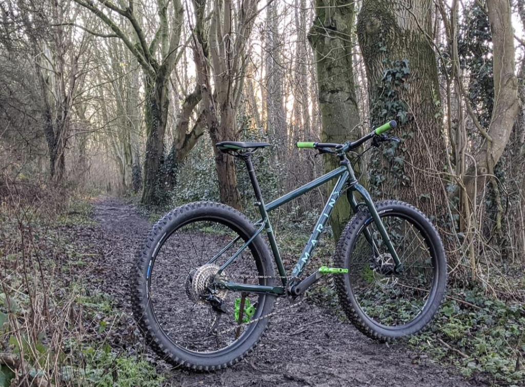

I fancy building up a bit of a Monstercross rig/weapon/sled for commuting, to try and stop myself looking at gravel bikes that I don't need.
I've got a Marin Pine Mountain which is currently more in a bike packing setup but could be quite nice for this.
It's got Jonesalike bars (not pictured) and Deore brakes, 1x10.
Screenshot_20240207-101432
I fancy some nice flared drops until such a time as I realise that I don't like drops.
What do I need in terms of bars, brakes and shifters to get it all working?
I know nothing about curly bar bikes so could use some pointers and recommendations.
I'd be fine with cable brakes.

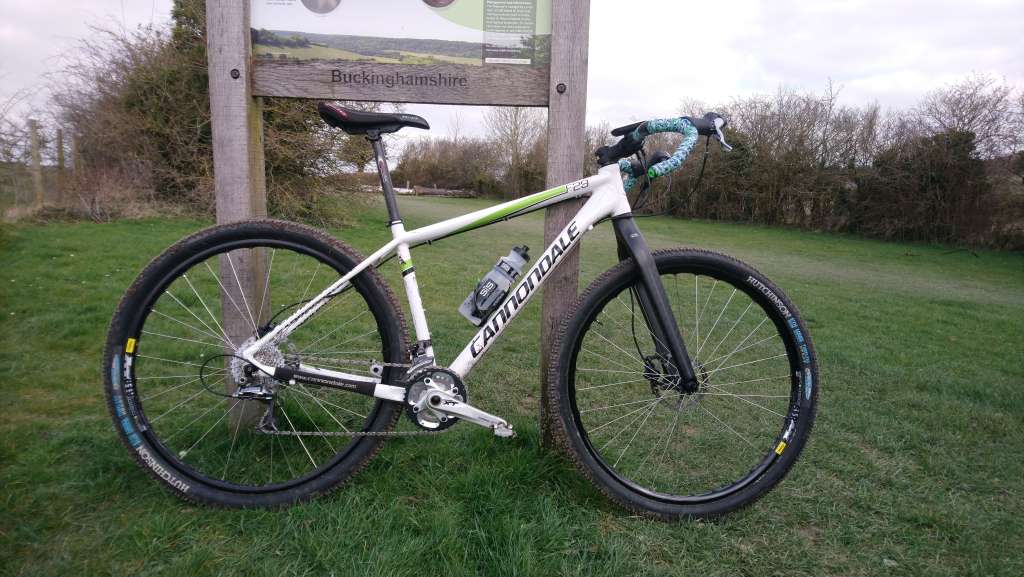

Agree that flat or alt bars make more sense for off-road, but for the shit that masquerades as roads in the Chilterns this with 2.3" smooth treaded tyres is great.
cannondale
