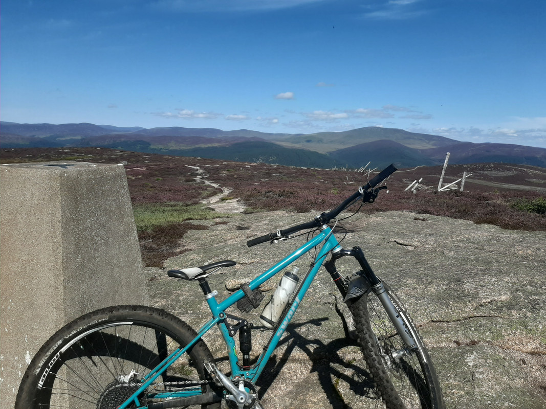

What bike is this going on?
Posted : 30/04/2021 4:22 pm
This one....my Swarf Contour(you can see the aforementioned Middleburn crank)
Posted : 30/04/2021 4:45 pm
