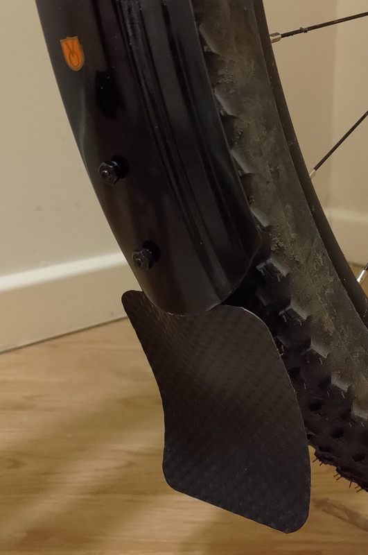

Posts: 3231
DIY flap out of damp proof course. Down to 10cm off the ground. Not sure how it'll hold up with the wind and spray against it, might have to yet buy a heavy flap and cut it down to length.
flap
