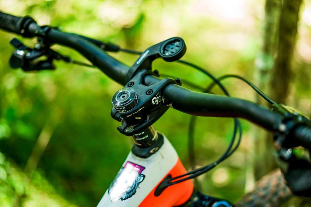

I’m similar. And have been able to reuse a fork on frames with different lengths.
Jack Moir is known for running a big stack of spacers. An old shot of one of his bikes:

Doesn't look pretty, but there's nothing fundamentally unsafe about it.
