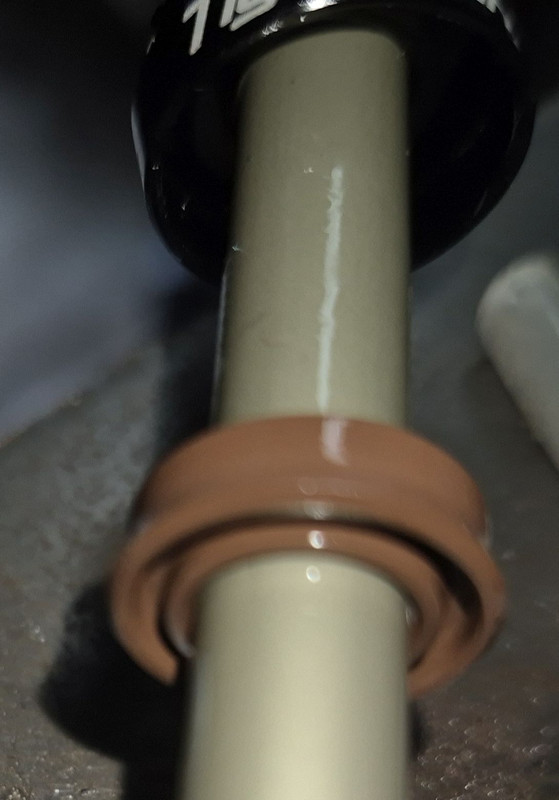

my Marzocchi 350ncr Ti forks dont  seem to move much so finally I took them apart.
I emptied the cartridge and tried filling it but the oil came out of the bottom of the cartridge body. It looks like its the U-Ring (41) that needs replacing. Any idea of its size? A quick measure shows 8.2/12.2/4.5 but its still on the shaft so thats probably wrong. Would it be 8x14x4.6?
And where could I get one?
https://postimg.cc/w3bD8b5j
https://postimg.cc/nX5HnBR7

Try Dr Zocchi for parts.

Trying! again!
Is this seal NBR or polyurethane , single acting seal, symmetrical, UN/USH/YA or what?
8x14x4? If its 4.6, would 4mm be OK to use instead?
