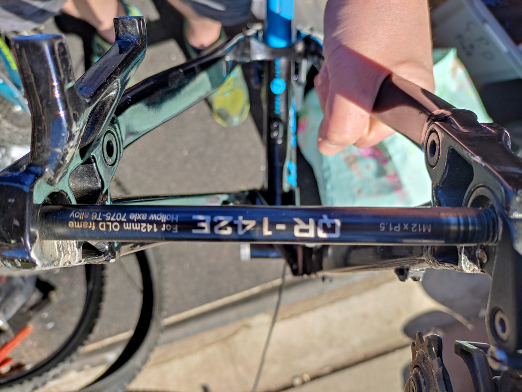

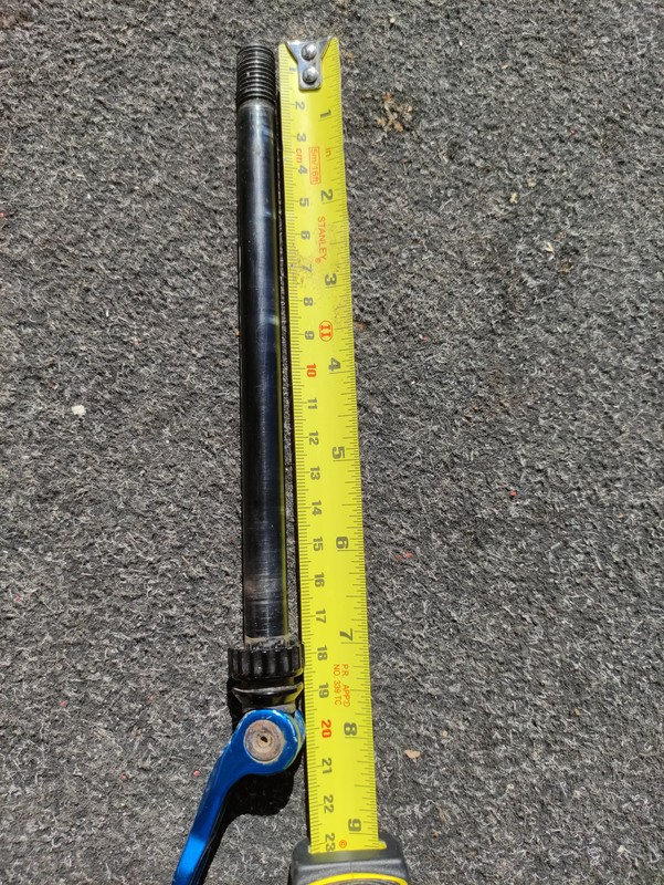

Yay! Forum seems to be back. Just posting here in case anyone needs this in the future...
Axle is M12 x P1.5 QR-142E for 142mm OLD frame.
Pic of axle and next to tape measure.
axle
measure
And it seems to be this one:
https://www.merlincycles.com/a2z-e-tru-142x12mm-axle-140687.html
Posted : 22/04/2021 12:37 pm

I've had confirmation from Marin that the spec is actually:
"The correct rear thru-axle spec for your Hawk Hill Jr = 168 mm_L1 {axle length}, 20mm_L2 {threaded portion}, M12X1.5 {thread diameter x pitch}. Marin factory part #728551."
Hope that helps for anyone in the future!
