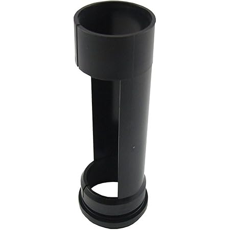

Maybe replace the bushings if they are worn or contaminated, and the seals, and lather the internals up in a low NGLI grease. I don't think there is any danger of the stanchion structural integrity being compromised.
The bushing is something like this.
Bushing
The item in the image is upside down and slides in from the top of the lower. The seal needs to be out to do it.
