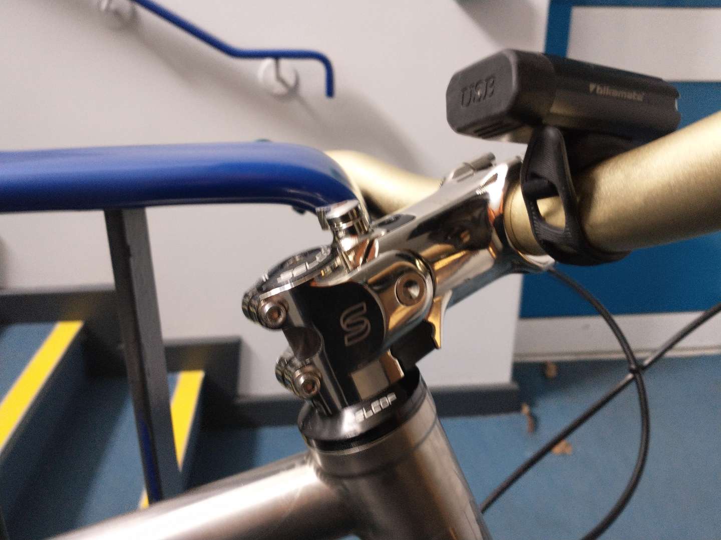

I've sacked off the Jones bars, gone back to MTB bars and bought a cane creek flex stem.
The stem was too wobbly with the softer elastomers. I'm on the hardest one and it takes away a bit of trail buzz.
I'm not totally convinced. I might just put a suspension fork IMG_20250321_075643125.jpg on.
