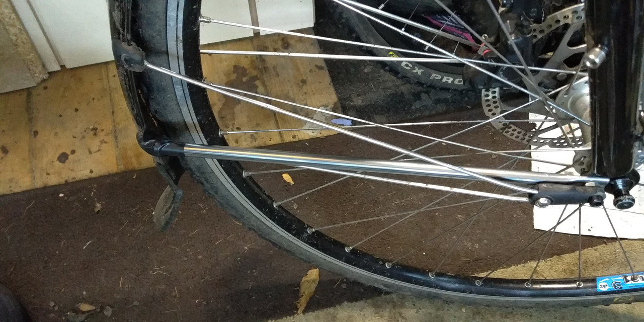

I make my stays from 6mm alloy tubing. Makes for a rigid setup and pretty well immune to crashes.

Epicyclo, any pictures?
Posted : 24/11/2019 9:41 pm
Posts: 17366
Click back and fore through these albums, and you'll get the idea.
[url= https://live.staticflickr.com/7500/16249542196_daf4d3e120_b.jp g" target="_blank">https://live.staticflickr.com/7500/16249542196_daf4d3e120_b.jp g"/> [/img][/url]
[url= https://live.staticflickr.com/5093/5523333070_e2b11a9fb2_b.jp g" target="_blank">https://live.staticflickr.com/5093/5523333070_e2b11a9fb2_b.jp g"/> [/img][/url]
Posted : 24/11/2019 11:05 pm
Very tidy. I shall purchase tube tomorrow, spend all day making a hash of it and just putting up with the rub.
Wish me luck!
Posted : 24/11/2019 11:49 pm
Bought myself some tubing as above and it's so sturdy I only needed to fit it to one side. No more rubs.
