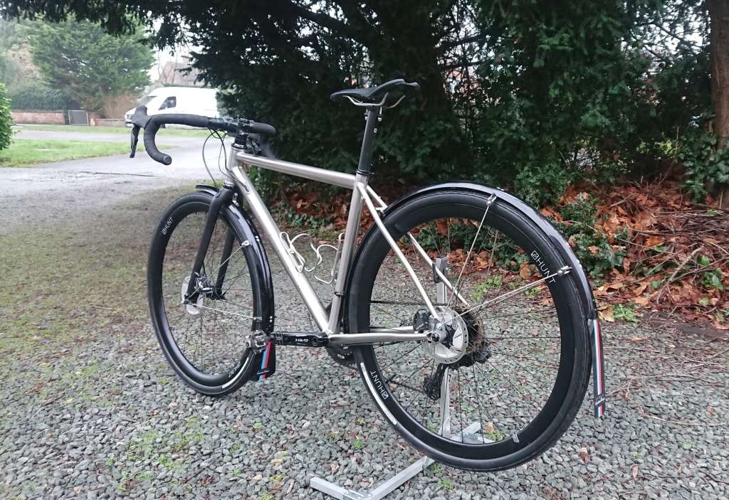

Here my Gradient in winter road bike mode. SKS Blumels 45s over Gravel King Semi-Slicks DSC_1395
