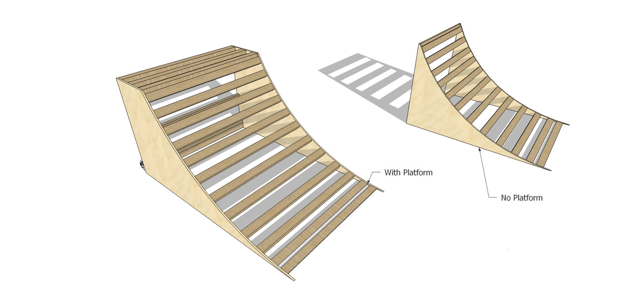

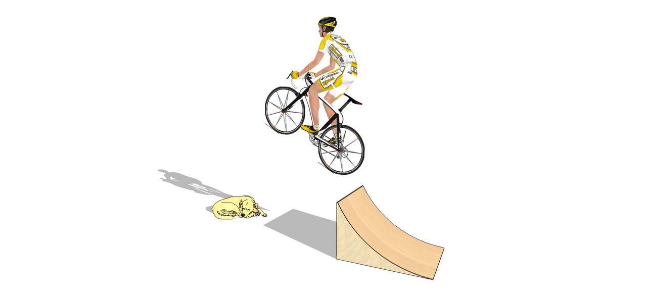

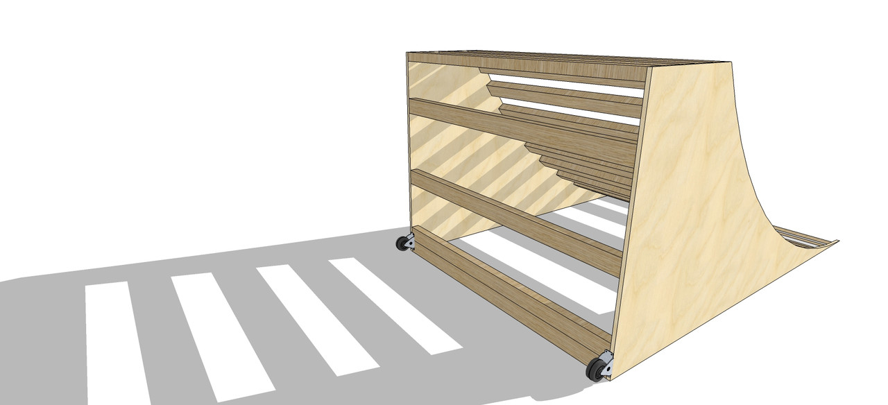

Well we started the project yesterday eve... managed to get the idea into 3D before darkness/youngest child stopped play!
12mm ply...
43cm lip height, with a 205cm radius... seems to be a bit steeper than the MTB hoppers etc (which have a 400-500cm radius!), but if we used a 450cm radius, the take-off lip would only be about 15cm high!
50cm wide.
Will stick in the rest of the struts to give good support, then either:
-kerf the wood for the ramp surface
-soak and bend
-screw that MOFO down with neither of the above...!!!
Prob go for option 1 TBH..seems the neatest idea?

"It’s surprisingly easy to bend plywood for a skate ramp. The amount of bend or curve you need in the plywood is gradual enough that you don’t need to use any special bending techniques. Ordinary plywood products can be used and you don’t need any heat source."
Easy then!
DrP
Posted : 10/09/2021 9:16 am
Posts: 4313
Possibly not so easy with 12mm ply. I used 12mm for the sides and 9mm for the top, pulled down easily using screws into the cross braces
Posted : 10/09/2021 11:14 am
Depending on the ply, you may well find that you can bend it, although I would reckon that 12mm will be fairly hard to bend. Possibly on a full-size halfpipe, not so much on a small kicker.
Some ply will bend easier with cross-grain, so the grain running across the ramp rather than along it.
You can always do two layers of 6mm instead, 3 even for uber-gnar resistance.
The issue with bending ply that wants to be flat is it'll try to spring back. Because where the ramp sides meet the floor you have a pretty thin and flimsy section, this can result in the ply bending slightly laterally and you'll get a hollow underneath the edges of the sides along the floor.
Wanging some sort of support along these sides as close as you can to the start of the transition can help to reduce this.
Ply is incredibly stiff in its own plane, but because it's cut so narrow it can happen.
Posted : 10/09/2021 11:20 am

I think i'm gonna add in a design change....
I'm a bit worried about the lip being right at the rear, so going to make it a bit like the one above..remove a portion of the take off, to bring the lip forward a bit.
Mights also remove some of the early taper...it's too thin to be useful!

aAAND...WE'RE DONE!
TBH..it#s fab! A lovely kicker that can be taken fast OR slow(ish!)
Son's loving it, and we're both chuffed with the build!
So there you go...you can smash out a wicked little kicker for £45 of materials!!!
