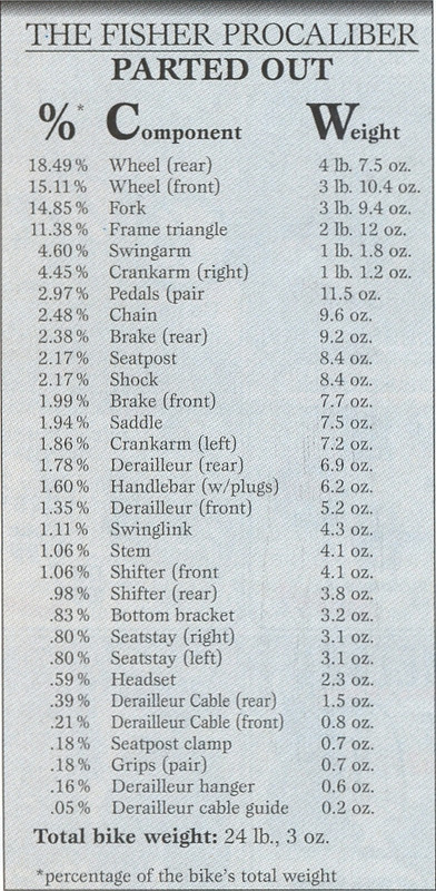

Rear wheel, front wheel, fork, Every bike is the same
Posted : 08/10/2018 8:50 am

It has to be wheels and tyres. Not only the biggest opportunity to lose weight, but also it makes the biggest difference in feel. My giant XTC came with Giant wheels and heavy steel bead OEM Racing Ralphs. Swapping the wheels for ZTR Crests, the tyres for decent folding ones and going tubeless saved well over a kilogram and made the bike feel totally different. My Jeffsy came with silly light wheels (DT XMC1200) but with Onza Ibex tyres that weighed well over a kilo each. Swapping the tyres for 2.35 Nobby Nics again made the bike feel much more nimble with no loss of grip for the type of riding I do.
Especially if for some reason you take the frame to pieces but not the wheels or fork...
