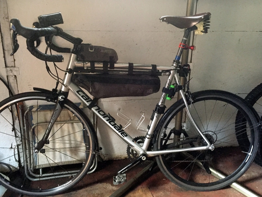

Thanks for the replies and compliments!
Not the best photo, but its the only one I took of it set up.
Food/ Drink
I had a load of torq gels. They taste awesome and don't give me any stomach ache. They were mixed in with a couple of bananas, a couple of savoury sandwiches and cake stop at 50.
For bike packing I've gone for a mixed bag of nuts, dried fruit and chocolate in the past but thought I'd try the roadie way this time.
Last time I did the ride I assumed there would be shops garages on the last 30 miles and there weren't. Hence the fully packed ride this time. I planned the route to be as quiet as possible, hence the lack of cafes.
I was definely fully hydrated according to the number of stops!
I was fully fuelled in the morning. I'd rather be up 10 min earlier to get a full belly.
Position
I've never ridden on the drops 2/3 of a ride before. I don't have the time to do super long rides at the moment. I ride to work most days as spend 1/2 the time on the drops, however that's only 8 miles per day.
I moved the saddle as far forward as it can go at 50 miles which helped the knee.
In Laws
They are lovely! The wind would have been much better on the return journey this time 🙂 I've had significant tail winds on previous rides. The prevailing winds are not in my favour
Wheels/ tyres
The wheels are tubeless ready, the tyres are not. The 25c were at 90. Still managed a slow puncture. There were a lot of neat hawthorn hedges...
I had to rebuild the front, when I put it in the frame it was true side to side but not vertically and I had run out of time to faff so bunged a shimano one on.
The 28's I have are about the limit of the frame. It was second hand to me, a 2010 ( i think) cannondale synapse
@epicyclo
I'm only single sprung and my bum was fine 🙂
Posted : 26/02/2020 9:23 pm

That looks like a pretty good setup to be fair.
I think I could be tempted by changing to clipon guards to accommodate a larger tyre, but that would be my personal choice, not necessarily what’s best for others.

Hand pain from the vibration over the last 50 miles.
Knee pain in my right knee, perhaps my saddle is squint?
Maybe. Brooks saddles can end up set further forward than std designs, as yours is and a forward saddle puts more of your upper body weight on the hands. It may be related to knee pain but it's as likely to be cleat positions or anything else.
My bars are high (for a road bike). Is dropping the stem a good idea given the neck pain above?
If your saddle and body C of G was further back and supported more by the legs/pedals you'd be able to lower the front with less negative effect on your arms and shoulders, it should feel looser and more naturally balanced. The sore neck may be more related to bracing/supporting yourself than the looking up.
Edit
Hmm. If that's what your knee needs it may be hard to do what your hands/arms/neck-shoulders may need. One for a good bike fitter perhaps.

Looks like a lot of stuff attached to your bike you could do without
But I've only done >200k a couple of times, so take that my opinion rather than advice

I stated in the dark. If it was a bit later in the year I could have ditched a couple of Kg of lights. Riding through the city and then into the unlit lanes at roughly rush hour made full lights a no brainier 🙂
in the end it took just over 11 hours. I was aiming for 10 but a couple of mates joined me for the first leg of the ride and they were slower than expected. The wind and an unexpected diversion added the rest.
