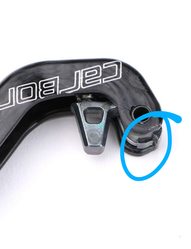

This is the problem. The brake looks to work ok but it rattles around as a result and I'm not happy with this on a brand new brake.
The good lever has a small metal section which overhangs the black lever blade to stop it extending away from the bar
It is hard to see in a picture but the other lever has that section snapped off

Iirc from changing levers that spring can slip out of place while you’re doing it so it might be worth seeing if it’s managed to unhook inside?
Alternative, unlikely, possibility- it’s definitely not in a different place? The levers are the same left and right and are rotated rather than mirrored, so what’s on top on one side is underneath in the other. Wouldn’t explain the free lever problem anyway, but just a thought
Posted : 26/09/2021 6:18 pm
I’m not happy with this on a brand new brake.
Are they new to you or new? There are no logo cover things on either of those brakes which suggests they're not box new at all but that they've been fiddled with (e.g. a lever change).
IIRC those bits you're pointing at are part of the lever assembly as purchased.
Edit yep, part of the lever assembly. Image from bikester:
Posted : 26/09/2021 7:34 pm

It is definitely broken rather than lost or rotated as the edge is sheared metal
The brakes are new, bought August. Yet to be ridden a only been to the LBS for the hose cut and flipping everything around.
Yes the stickers are removed as they look gaudy. Magura sell custom stickers so I am sure they won’t mind me undertaking that complex mechanical task 🙂

Sooo... reply is in from Magura Germany. Seems like an email from a macro in their support system that they have had to send a lot of times before.
Short summary: That part is designed to brake away in a crash to protect the rest of the unit. Brake is fully functional if there is no other damage. Kind of what was worked out so far.
"Unfortunately, we cannot clarify the reasons that led to this cracked stopper. In any case, this does not represent a warranty defect or quality problem".
Seems like a quality problem to me if it can happen in the box or if it happened during the LBS bleeding the brakes (unlikely as I trust them but I suppose possible).
I am not over the moon as the extra rattle without that stopper is really annoying. I am a bit precious about rattles and noise on the bike though. Not great that Magura aren't interested but my cynical view is they probably know that part is fragile and will go again sooner or later. Hmmm...

Not the most interesting thread but a bit more information in case anyone finds themselves in the same boat with a two way Magura lever.
"The required force to break away this part is not very high. The lever blade is designed to return always to it´s initial position, even with the part broken away. Please note, a new purchased lever blade with this part will have a very similar behaviour."
Or in other words, we won't replace it because a new one would break at a random time too and they are satisfied the brake still functions safely without the stopping tab.

My mt7s two finger levers did that out of the box. You could always push the levers away, but they were fine when hammering down trails. They did spring back, if they don't it seems wrong.
In classic stw style, I swapped them to hc3 levers, which made great brakes fantastic imo. Pity they didn't come as standard. Depends how OCD you are about brakes.

Ah ha, why didn't Magura just say they have levers with a different design! Assuming that stopper part is more robust on the hc3 @jsm?
Posted : 28/09/2021 11:55 am
 jsm
Posts: 285
Yes, doesn't flip out. The contact is solid against the piston.

@mahalo you're missing (at least) a bit from that lever.
There should be a "BAT adjuster" or at least a pin/plug arrangement thingy in the hole immediately above the hose entry.
With Bat adjuster
With plug thing.
This bit, should hook onto that adjuster/plug and provide return spring tension.
