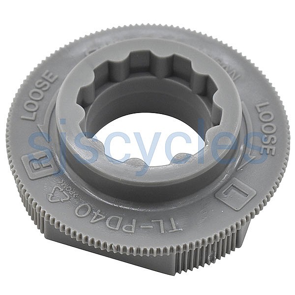

Do you need a special tool to get them apart? Or am I confused?

You do need a specific tool,
But it isn't megabucks

Alternatively buy a pair of M540's and you can use a spanner.
Posted : 21/01/2016 4:49 pm
Posts: 943
Yes. A little plastic socket made by Shimano
540/XT don't need one.
