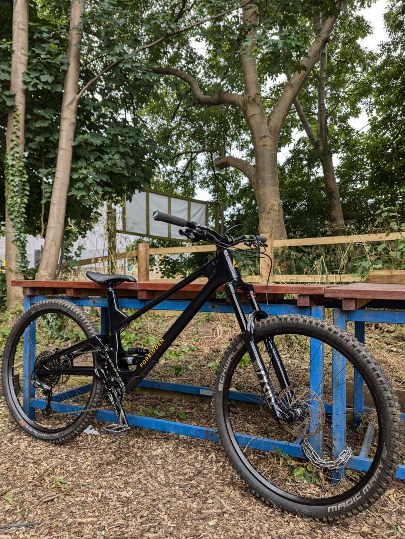

I've got one of these previous generation Lyrik Ultimate's on my Druid. It's not doing it for me anymore.
On the plus side, it's very smooth and supple. It rides light and lively rather than being slow and heavily damped. It works very well on small bumps and tracks the ground perfectly.
The downside is that it rides really low in the travel. It was originally 160mm with the old style air spring which sits at 10% sag at rest. I've fitted the correct length shaft for the bike (150MM) with the updated air spring which is supposed to increase mid-stroke support. Now it sits at zero sag unloaded but I can't feel any difference in support. I still feel like I'm using all of the travel all of the time.
I've tried all the volume spacers. I feel like it just reduces the usefulness of the available travel. It still dives but then crashes into a wall of progression which makes it feel harsh on big hits. I might refit the 160mm shaft but keep the new piston to regain a bit of ride height.
When I got this fork (it came fitted to another bike) I was recovering from a lung infection and a hip injury. I was an absolute cabbage with a limp. I thought it was fine but now I'm getting fitter and I'm going back to steeper, rougher trails and uplift days and having the fork diving everywhere just feels dangerous. Or I can fit volume spacers and feel like I'm crashing into a bumper all the time.
If anyone is aware of any mods or upgrades available to make the Lyrik more supportive I'm all ears. Not like Smashpot money. Above a certain price bracket I'd rather just buy a new fork.
Alternatively: What is the best trail/lightish air fork available to mankind and where can I find one with 40% discount?
For context: I really miss the Ohlins RXF36 from my Privateer 141. I wish I'd kept that and sold the Lyrik. It used to ride much higher in the travel and take big hits with ease. I have the RXF38 on my party bike and that's the same. It's supple and supportive and takes drops and g-outs like a champ. They're both the best air forks I've ever ridden.
The new Lyrik in red looks mint but they're bloody expensive and I'm not convinced it'll solve my problem. I've always been Selva curious, maybe it's time to try one. There is a new RXF36 but there's no reviews anywhere yet. I'd have to wait for Black Friday and hope for the best if I wanted one of those.
