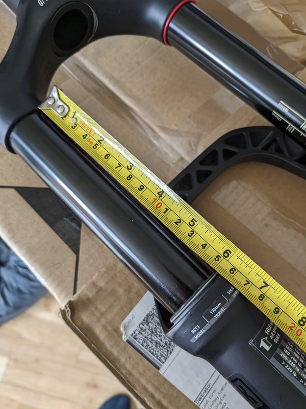

Just took delivery of a "new" Lyrik RC3 170mm fork. Despite the listing, trailhead app and sticker saying it's 170mm, it looks like I only have 150mm of stanchion showing. My old RC2DH shows a full 170mm unsagged so I'm thinking something is off with the new one? It has the right amount of air in. Anything I need to check before asking for a refund?
lyrik

Seems odd as, as you've shown, clearly labelled as 170mm. Can you pull the lowers down whilst supporting uppers to see if it'll expose further stanchion or whether it physically isnt possible?
Posted : 31/08/2023 1:45 pm
Posts: 9175
@nuke I can pull the lowers down to show the 10% sag marker on the 170mm section but it's very hard and it goes right back to where it was.

If it's sat into its travel (you said pulling down exposes the 10% marker) then I'd agree with others it's almost certainly the negative air spring pulling them down into the travel.
Once solution may be to pump the forks up to high pressure (for a very large rider), compress and extend them as much as possible (by hand to pull them back to zero-travel), and with a little luck anything blocking the port between the air springs will shift and they'll be fine. Release the air and go back to your normal pressure.

I've had success sorting the same issue by letting all the air out, stand on the axel and then pull the crown up (or handle bar if attached to the bike) as hard as you can. It forces the air back to where it should be and cleans the transfer port out.
Posted : 31/08/2023 3:55 pm
Posts: 10225
It does sound like it’s sucked down. Any idea which airspring is in it? If it’s a B1 Debonair spring they were more susceptible to sucking down just under the weight of the bike without even having a rider on it.
Alternatively it could have started life as 170mm travel but had a 160mm or 150mm air shaft put innit at some point.
The only way to tell 100% is pop the air shaft out for a look. That means letting the air out, taking off the air side top cap, removing the lowers and then undoing the circlip that holds the air shaft in. Then giving it a sharp pull to pop it out. I don’t know if the air shaft has any numbers on it that mean anything in terms of length or if you’d need to measure something. It’s not a terrible job but you’d need new grease and lower leg lube to reassemble afterwards.
In the meantime you could try a couple of things:
Let all the air out and cycle the fork up and down. Then pump it to 50psi, then cycle again, then another 50 psi, cycle again etc and see if the fork then stands up mor
If that doesn’t do anything you could try slipping a very thin zip tie down inside the seals on the lowers to see if there is air trapped in the lowers.

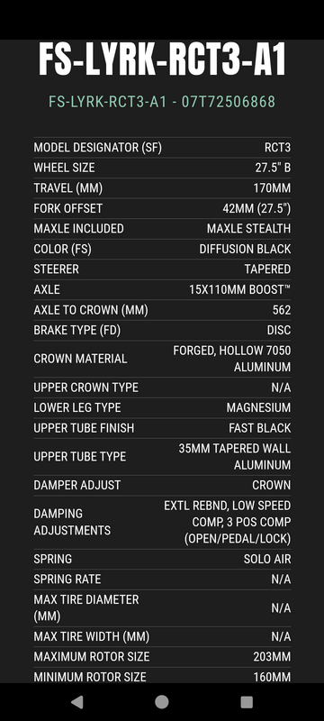

Tried all the above and still sucking down. No idea which air spring it is, the specs say A1
specs

The airshaft hasn't been swapped to 150.
If it had you wouldn't be able to have got it up to 155 then also been able to pull it up another 10mm.
If it was a 150 airshaft it'd be 150 max no matter how hard you pulled it.
It just air trapped in the negative side of the spring.
Put the axle in. Put a stem and bars on the steerer.
Pump it up to max pressure.
Stand on the axle them pull it up as hard as you can.
Hold it there until you hear a slurping noise.
Measure it then and it'll be as close to 170 as it can get.

@singlespeedstu I've just tried that (and every other burp fix online!) and none of them are working so it will have to come apart I guess.
