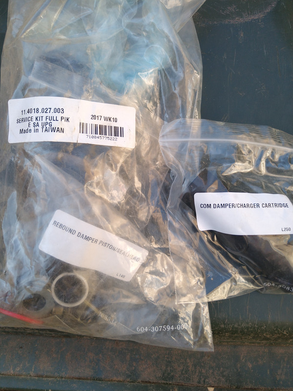

If it's the same bladder as the A1 Pike I have one you can have for postage. Unused, obvs.

It's all I have left from this kit:

Thanks is it 29+ and 2017 ish? If so think it will fit.
Posted : 13/09/2020 4:23 pm
Posts: 3879
It was 2017, 650b.

No idea if it's the same, sorry. It's yours if you want it. Can post tomorrow am.

The lyrik and pike bladder are different lengths. I thought I might be able to do the same but after investigation I found they were slightly different. Lyrik is the longer one. Not sure what the actual measurement diff is however.
I was hunting for a lyrik B1 bladder and you can only get them in full rebuild kits, which are 50 pounds or so. The only place I found just the bladder was in New Zealand!

Pike A1/2 uses a short straight bladder, Lyrik B1 uses a straight longer bladder, Pike B1 and Lyrik C1 use a hour glass shape bladder, both the same length.
RS dont sell the B1 or C1 Lyrik bladders IIRC or if they do sell the B1 version they ar every hard to get hold of. Drop me a message and I gave sent you a WSS one tomorrow.
