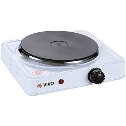

Goes off to find a cheap or second hand fryer
One of these for 12 quid does the job...
