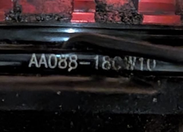

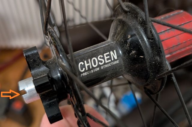

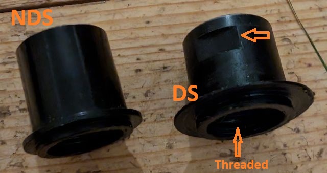

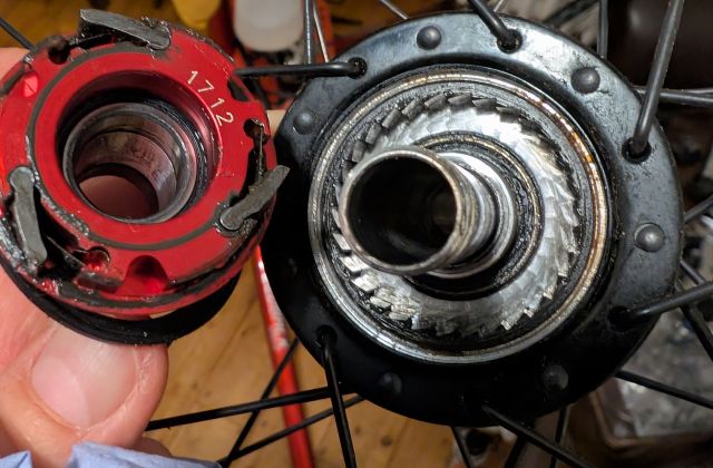

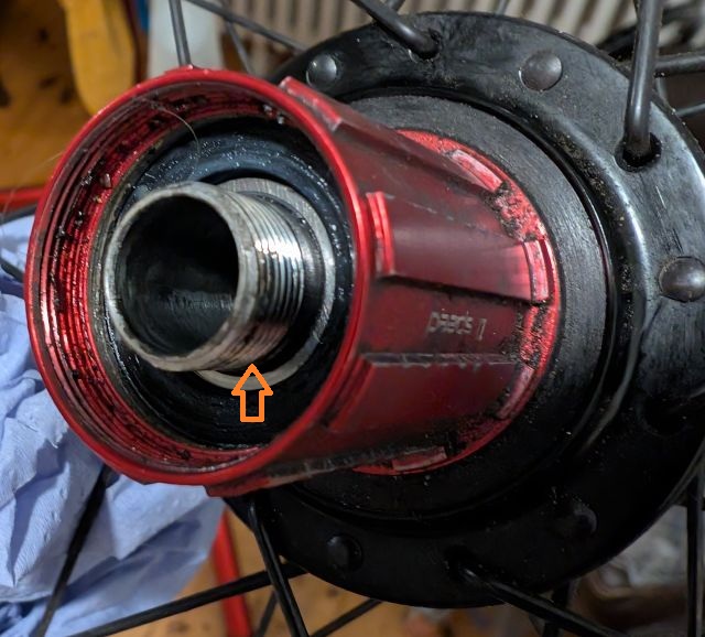

I have a wheel set with this rear chosen hub (Raleigh RSP with Alex rims draw 1.9 rim). It is currently 12mm but I'd like to use it on a QR frame. Does anyone recognise the design enough to be able to recommend an adapter set that will fit. Search has revealed the Sun Ringle, Stans and Progress (among others) rebrand chosen hubs.
  • Hub is labelled AA088-18CW10
  • Freehub labelled 1712 (HG 11 speed road)
  • Drive side cap threads on (I'd expect a DS QR to maybe have an allen key shaped hole instead of flats, sure I have seen a Sun Ringle hub like that before)
  • Non-drive side is push on with an o-ring (note distinctive cut out in axle to help undo DS cap)
  • Freehub slides off when DS cap is removed.
I also have the matching front hub that is currently 15mm that I'd like to run QR, though that is somewhat easier to do with reducers.
PXL_20251022_201431753 - Copy.jpgPXL_20251022_201214954 - Copy.jpgPXL_20251022_201307124 - Copy.jpgPXL_20251022_201249079 - Copy.jpgPXL_20251022_201504914 - Copy.jpg
