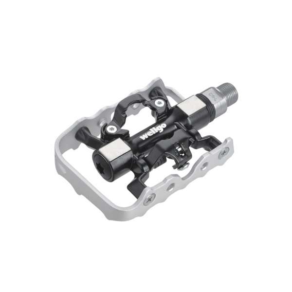

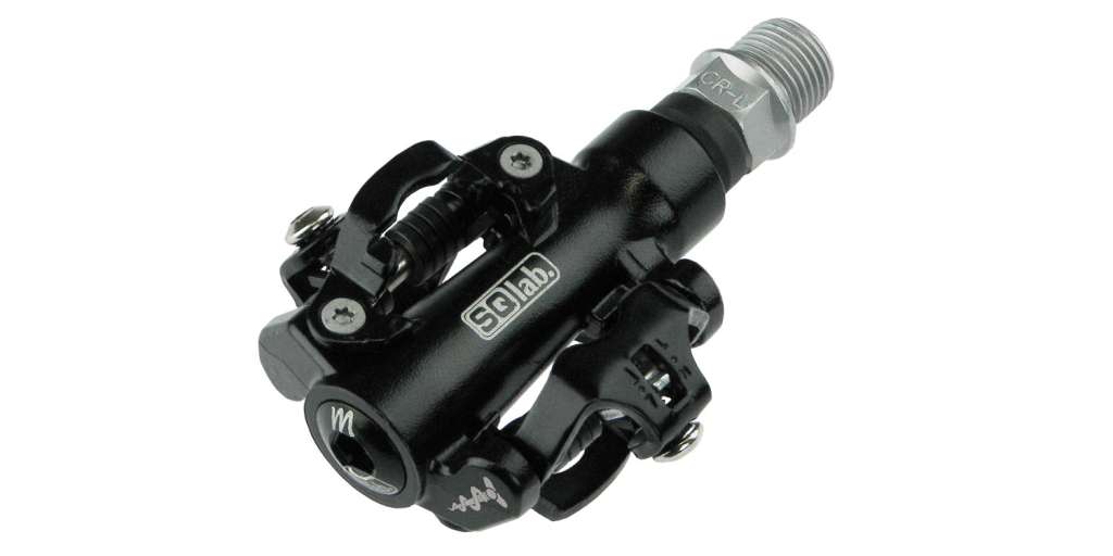

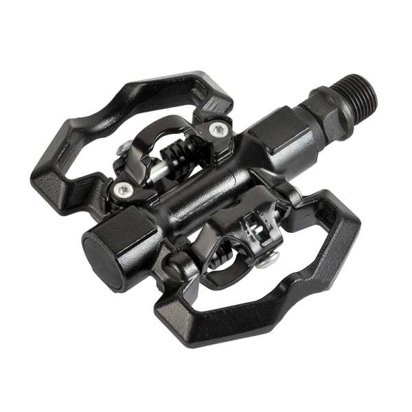

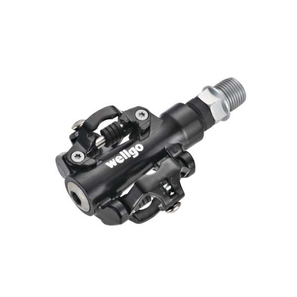

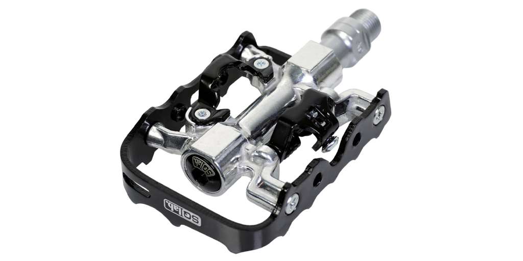

Posts: 4788
@MSP
I have some of flat pedal 50X in wide (actually no wider than HT PA03a..), but for their SPD pedals, I believe that they are made my Wellgo with custom axles (and a heft in price)
Wellgo m094B
201306060940141
SQLab 511
sqlab.pedale.511.main
and:
Wellgo C176B
C176B
SQLab 502
sqlab.pedale.502.main(2)
might be possible to so some swaps reckon for example, the SQLab 502 longer spindle would (appears) fit the body of the Wellgo M221 as they seem to share the same centre body design - may be other options also:
