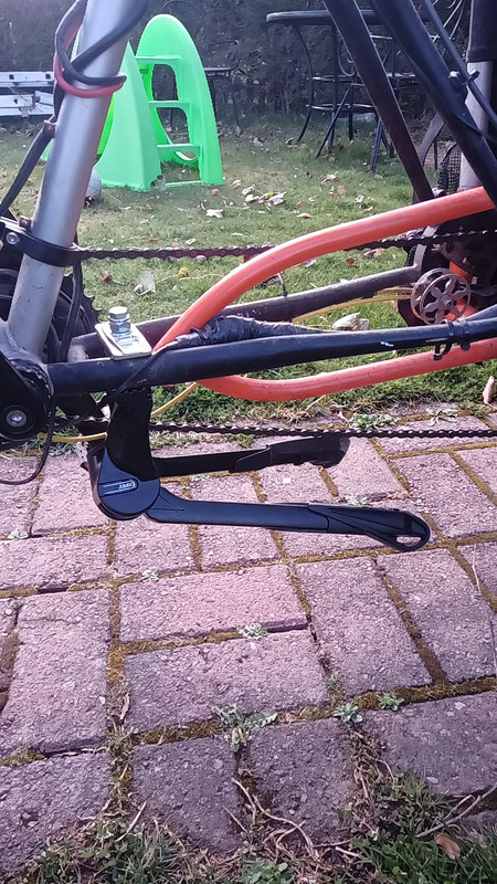

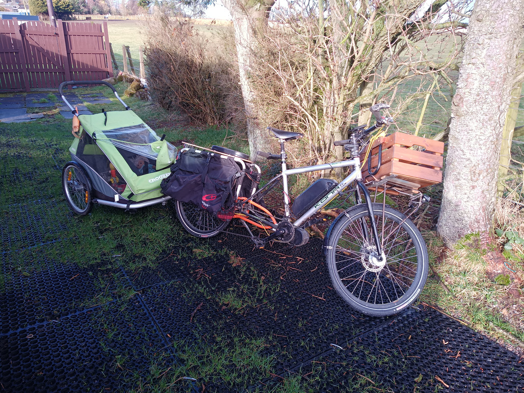

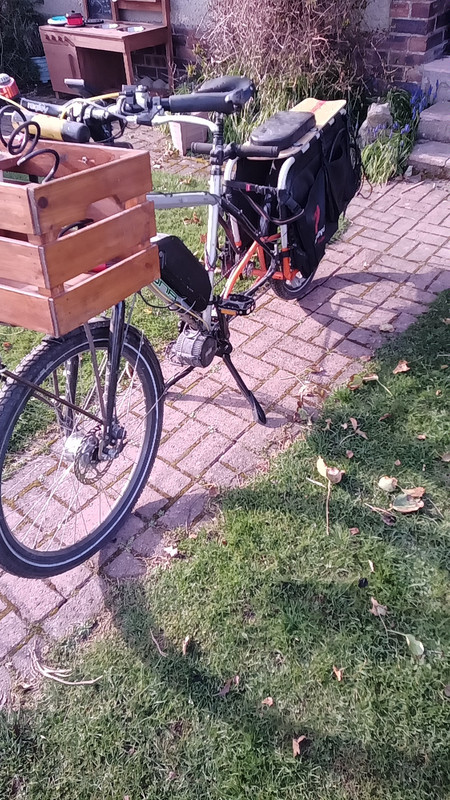

Another cargo bike question.
What you all using for a stand ? I've got a kick stand which is fine for mounting trailer and parking and the cargo outriggers to lean it on when putting heavy things on
But thanks to Nixie I'll have the bairn on the back shortly and so what to get a centre stand for loading our and about. Rolling jack ass is out and the rollback will require modification to fit the freeradical and would have to come from the usa and rather more importantly doesn't get great reviews from users .
Looking at ursas Jumbo or the hebie rex . I'll need to modify either to fit but I have plans to over come that -anyone used either the ursus says good for 80kg.
Posted : 25/03/2021 12:36 pm
Update for anyone with the same 200 dollar problem.
Solid as a rock I had to swap the supplied bolt for a slightly smaller one to fit through the tongue of the free radical. If it does become an issue I'll modify the free radical but given the free radicals been held by that bolt for 5 years I'm sure it'll be grand.
Only reservations are ground clearance is compromised somewhat but then it's a long tail cargo bike......we ain't doing steep roll ins are we.
It's a long ursus jumbo 32 quid.
Posted : 05/04/2021 4:48 pm

Looks like a great beast that. Never got round to fitting a 2 legged stand on mine but it would have been a good thing. The single leg was better than on a normal bike as the wide mount meant it stuck out further but you did have to start on the stand side with loading, particularly heavier items like compost. Seeing your electrified setup looks the ideal load / could carrying dad bike.
