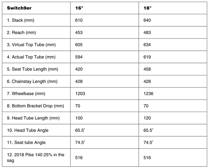

In my next project quest I'm looking at building up a Longish slack hardtail with existing parts. Without going for Boost adaptors on my existing rear wheels I'm just wondering what might be out there in the way of frames (second hand) which are 142x12 rear and designed around a 120mm ish fork.
I'm thinking 460mm ish reach 66 ish head angle and no longer than 460mm seat tube. steel or alu. 2.5" tyres.....

A slightly under-forked Stanton Switch9er would probably hit most of your marks. Clearance for 2.5 may be a bit snug depending on tyre choice. Or a custom Sherpa with shorter seat-tube...
