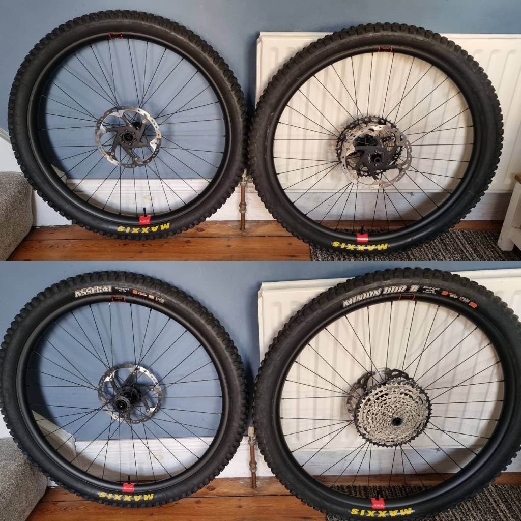

We've all been there; the rage, the tears, and the confusion at the limp rubber sat in your hands. Your pride utterly dented by the mess of sticky fluid covering workspace from repeated adjustments; exhausted from the rapid pumping to trying and breathe life into the probabilistic part.
The cries skywards to the bike gods. whilst prostrate in the cellar/garage/back garden/drive fighting back the tears of frustration at the cycling equivalent of emasculation.
Then I got some Reserve Filmore valves and had it up in a matter of minutes with nothing but a track pump and a smile. 🤌

Bloody beauts!
Logo/valve alignment isn’t quite as good on the right hand example…
Posted : 12/07/2023 8:01 pm
Posts: 3317
I know, I'm trying to ignore it but I think that'll end up a post-house move job. 😂

Might want to check your radiator... Looks a tad 'droopy' in the 2nd pic 😉
