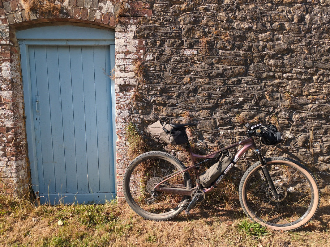

20240331_131514a
Very nice couple of hours out on the 7.9 yesterday.
It's a pretty decent allround xc bike. climbs well, relatively active, but not noticably bobby, light, climbing traction seems to be good too.
Confident descender too. yesterdays ride included a long fast rocky descent and it handled it really well. I think I need to spend a little more time setting up the forks, as i found them a little unbalanced to the rear, but I'll fettle a bit more..
the low front end isn't actually that low once you get on it. There's plenty of scope for adjustment too. I think mine is slightly too high as I started to get a bit of neck pain after about an hour 20. This is not unque to this bike, I started to get it a couple of years ago with some bikes and have been pretty sensitive to bar/saddle height since.
Low BB had me strike pedals a couple of times running 175 cranks. may have been my poor technique, or being used to 15 year old bike geometry.
all in, it's a bike that kinda just gets on with being a bike. I'm pretty happy with it. (for now ;-))

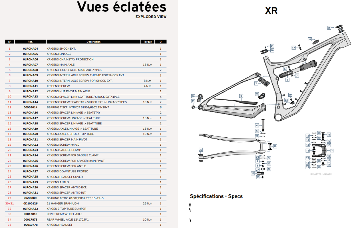

Posts: 125

Nice one! Do you have that as a pdf or just image?
They just sent that small image. I wonder if it's worth acquiring a set of replacement bearings in advance, or whether they're common types that could be easily sourced.

I wonder if it’s worth acquiring a set of replacement bearings in advance, or whether they’re common types that could be easily sourced.
looks like common ones, though they are matrix bearing, solid lube
No 12 https://www.bike24.com/p2283455.html
No 29 https://www.bike24.com/p2283418.html

Posts: 3300
Main pivot seemed to have a bit of movement, bolt was done up tight, so I stripped it all down
20241019_135556
One thing I can say is that it's definitely not skf matrix bearings, not configured like the drawing. The main pivot bearings are in the frame, not the swingarm, with the pivot bolt having tapered ends to nip down onto the bearings.
The linkage bearings themselves are marked JNK, all VRS seals with one having slightly different colour blue to the rest, which was odd. That one was rough as hell, the rest seemed to have a little play but we're smooth.
20241019_135215
Main pivot bearings are black seals rather than blue, no name and VRS sealed. These are smooth but have a fair amount of resistance.
The discoloration on the main pivot bolt and drive side spacer suggests to me that the bearing has been sticking.
Only thing left for me to do is reassemble the main pivot and check that the swingarm isn't worn. :-/
Posted : 19/10/2024 2:51 pm

All reassembled and torqued up and there's no play in it. However, the linkage bearings are rough and the shock link bearings are slightly wobbly so it's being retired until I can get it all working happy again. Probably with some max bearings instead.

I've gone in the other direction from racing and tried bikepacking recently:
The saddle pack is a bit stupid but with the semi-lockout has just enough clearance.
I also attempted SDW in a day on this bike a few months ago, although I bailed about 75% of the way through. Best of luck for the 12 hour attempt!
