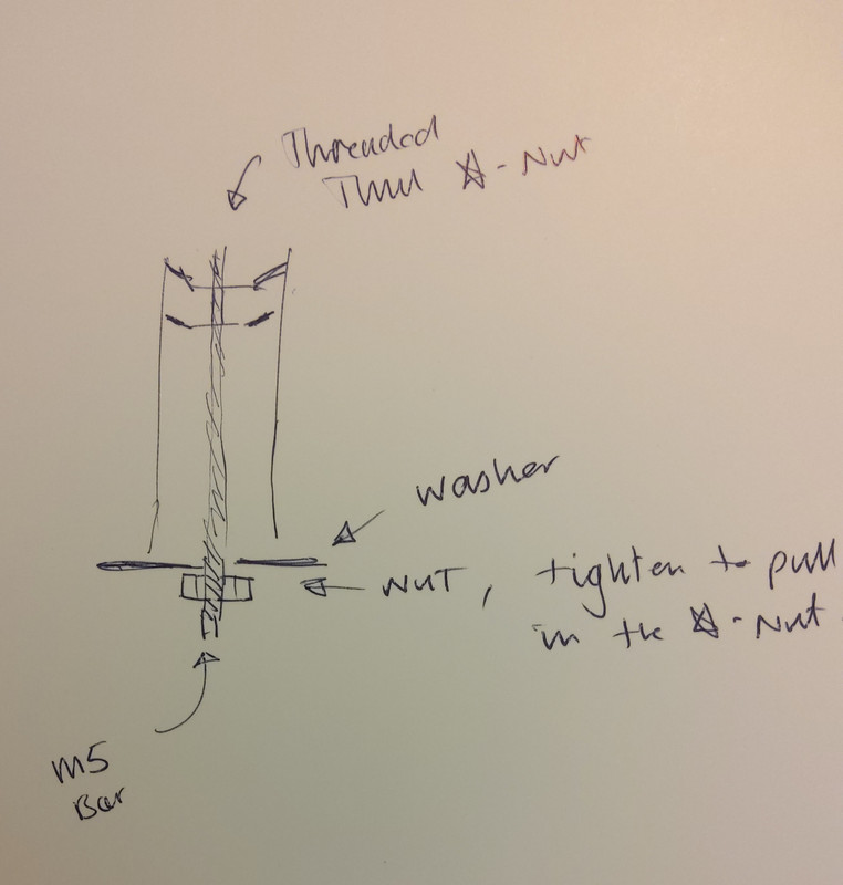

Proper star nut setting tool, one of those why didn't I buy one of these sooner moments the first time I used mine.

Proper star nut setting tool, one of those why didn’t I buy one of these sooner moments the first time I used mine.
I use an old quick release with the lever removed.

Posts: 2862
A long piece of M5 threaded bar, big flat washers and a nut. Instead of pushing the star nut into the steerer tube from the top, use the washers on the bottom of the tube and pull the nut in.
star nut gizmo
