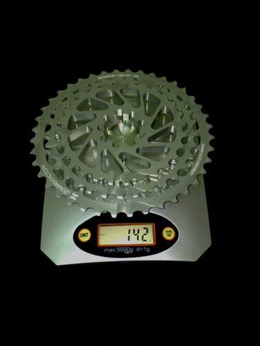

On the weight of the General Lee sprockets, I'm converting an XT 11-36 10-speed cassette, so I'll be replacing the 3 large sprockets, the ones on the aluminium spider. I weighed them at 186g for those three. I weighed the General Lee replacements at 164g, so that'll actually be a little lighter.

I can't believe the hunks of Italian metal weigh less than the sprockets on my bike, which is all I had to compare to, but I'm not 100% au fait with current set-ups.
They do though, regardless of whether it seems likely. I weighed them myself last night on a set of digital kitchen scales. It's not going to make your bike noticeably lighter but they definitely are measurably lighter.
They are far more machined out on the back than you are likely to have appreciated from the photos on the net.

O.K, here's a few pictures of the Shimano one:
[url= http://farm4.staticflickr.com/3814/9510418533_ff8ea5207f.jp g" target="_blank">http://farm4.staticflickr.com/3814/9510418533_ff8ea5207f.jp g"/> [/img][/url]
[url= http://farm8.staticflickr.com/7347/9510420505_f43a2a9b2e.jp g" target="_blank">http://farm8.staticflickr.com/7347/9510420505_f43a2a9b2e.jp g"/> [/img][/url]
[url= http://farm8.staticflickr.com/7288/9513211830_9d5c3a1df6.jp g" target="_blank">http://farm8.staticflickr.com/7288/9513211830_9d5c3a1df6.jp g"/> [/img][/url]
Posted : 15/08/2013 11:08 am
Here's it installed:
[url= http://farm4.staticflickr.com/3686/9510431471_444228e655.jp g" target="_blank">http://farm4.staticflickr.com/3686/9510431471_444228e655.jp g"/> [/img][/url]
[url= http://farm8.staticflickr.com/7441/9510427675_33a8221cdd.jp g" target="_blank">http://farm8.staticflickr.com/7441/9510427675_33a8221cdd.jp g"/> [/img][/url]
Posted : 15/08/2013 11:10 am
And here's a few pictures of the tweaks I made to the tooth profiles with a dremel:
To help it drop to a smaller sprocket (look at the second sprocket):
[url= http://farm6.staticflickr.com/5448/9513222972_d233cd76f3.jp g" target="_blank">http://farm6.staticflickr.com/5448/9513222972_d233cd76f3.jp g"/> [/img][/url]
And on the back of the teeth (look at the largest this time):
[url= http://farm6.staticflickr.com/5463/9513225164_41483b54cd.jp g" target="_blank">http://farm6.staticflickr.com/5463/9513225164_41483b54cd.jp g"/> [/img][/url]
And to help it climb up:
[url= http://farm3.staticflickr.com/2878/9510440953_ac7a00dca7.jp g" target="_blank">http://farm3.staticflickr.com/2878/9510440953_ac7a00dca7.jp g"/> [/img][/url]
Yes, I know that my bike is dirty and my garden and basement are a mess.... 😀
Posted : 15/08/2013 11:13 am

robin- those modifications to the cassette, are you not basically just wearing the teeth out by dremel-ing them?? thats how my worn cassette starts to look after a couple of chains etc
genuine question, as im intrugied by this but im running a medium cage too and if it needs what looks like you've done to it then im gonna leave alone 🙁
Posted : 15/08/2013 1:06 pm
I've only taken material off the sides of the teeth and a little off the tops. The very sharks fin shaped tooth was already like that and the material is off the trailing side.
I haven't directly touched the loaded surfaces of the sprockets and only the second set of chamfers, the ones on the back to help it drop down, have taken anything off the width of the loaded face of the teeth.
The rest of the modifications are all on the trailing face so should make no difference to the wear. The teeth are much wider and taller than the standard steel ones anyway, which is probably part of why it hold the chain too well, and I've only taken perhaps 20% off the width of maybe 10-15% of the teeth. To be honest unless the chain was worn out the load will be carried further down the teeth than I've taken any significant material off.
It looks like it's a little worn, but if you have a look at a brand new shimano sprocket, it had all the same shaping, albeit some of it is achieved by physically twisting the teeth which I wasn't going to do with aluminium.
I'm not concerned about the effect that my mods will have on it's lifespan, and basically it came down to it not working satisfactorily without the mods so it's a no brainer for me.
It'd be great it they did it at the factory but looking at it and how it was machined, I can see why they didn't, it'd need a good bit more fiddly work on a different machine and the cost would go way up.
It wouldn't put me off buying another if I needed one, it still makes it possible to get a set-up that you have any other way - a super wide range 1x set-up with Shimano shifter and mech.
Posted : 15/08/2013 1:27 pm
