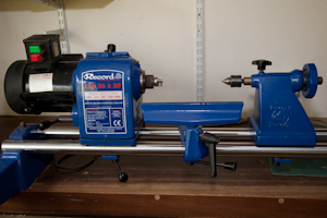

Wood or metal lathe? I have a woodturning one I may part with. A Record.
Posted : 18/05/2012 4:03 pm
kayak, which record is it? i may be interested.
Posted : 18/05/2012 4:06 pm
Like this one I think. Its been at me Mums garage for a couple of years so I've not seen it for a while. Have to dig it out and check it over.
