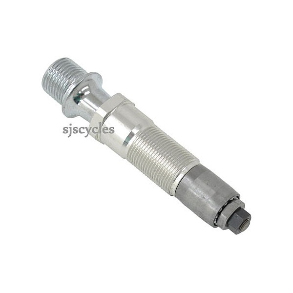

I should say as well, when you have the axle assembly in your hand, check for any play between the axle and the end cup section bit the bearings are in (see image)
so from that image you have (bottom right to top left):
lock nut
cone
bearings
cup section (with the bearings in both ends)
locking collar
axle
it's play in the bearings your looking for. The locking collar should be relatively loose.
