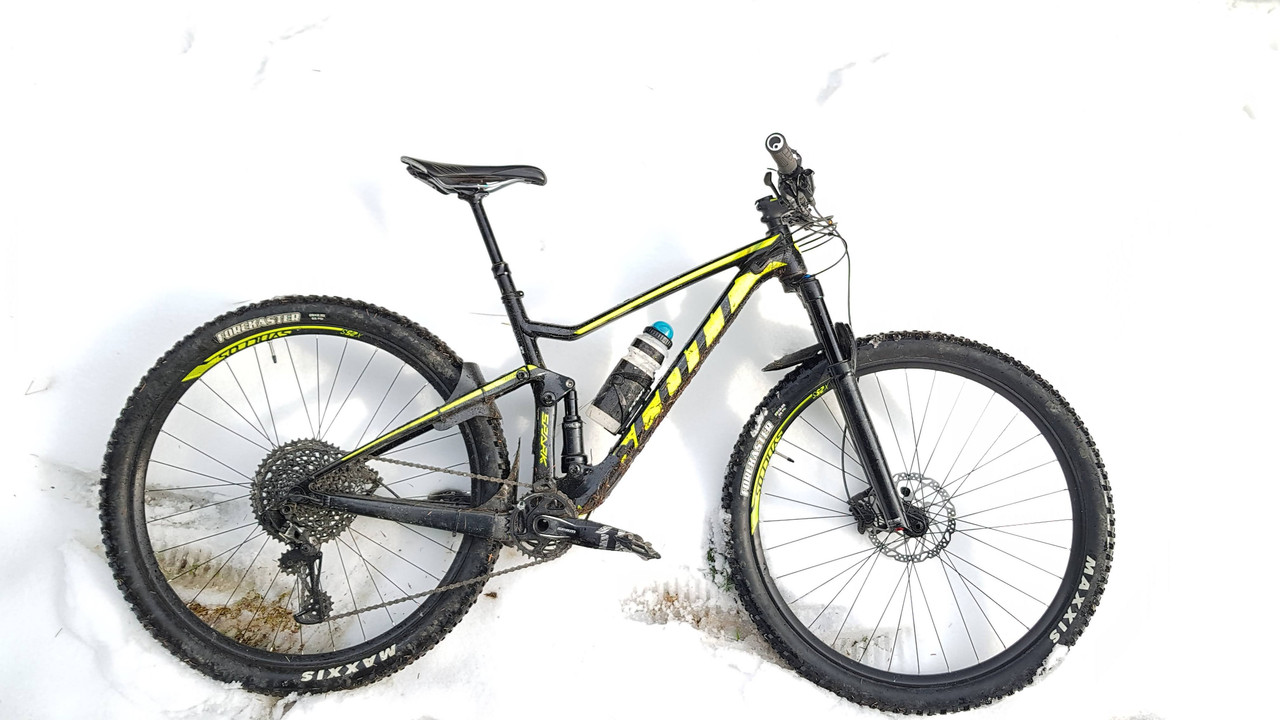

Posts: 300
I have a spark and this kind of "mini-guard" at the top and bottom keep the worst of the grit / spray out.
<img src=" https://photo Spark_Snows.app.goo.gl/zSx2QJDQcy3eCKPB9" alt="Spark_Snow" />
Spark_Snow

Posts: 1642
Thanks Kneed, where did you get the guards from?

Posts: 300
Yea they're made from bendy fenders. I think those ones came from decathlon. £2 each iirc.
The one by the chain needs a bit cut out of it for the chain to move into bigger sprockets. You won't know how much to cut til you fit it.
