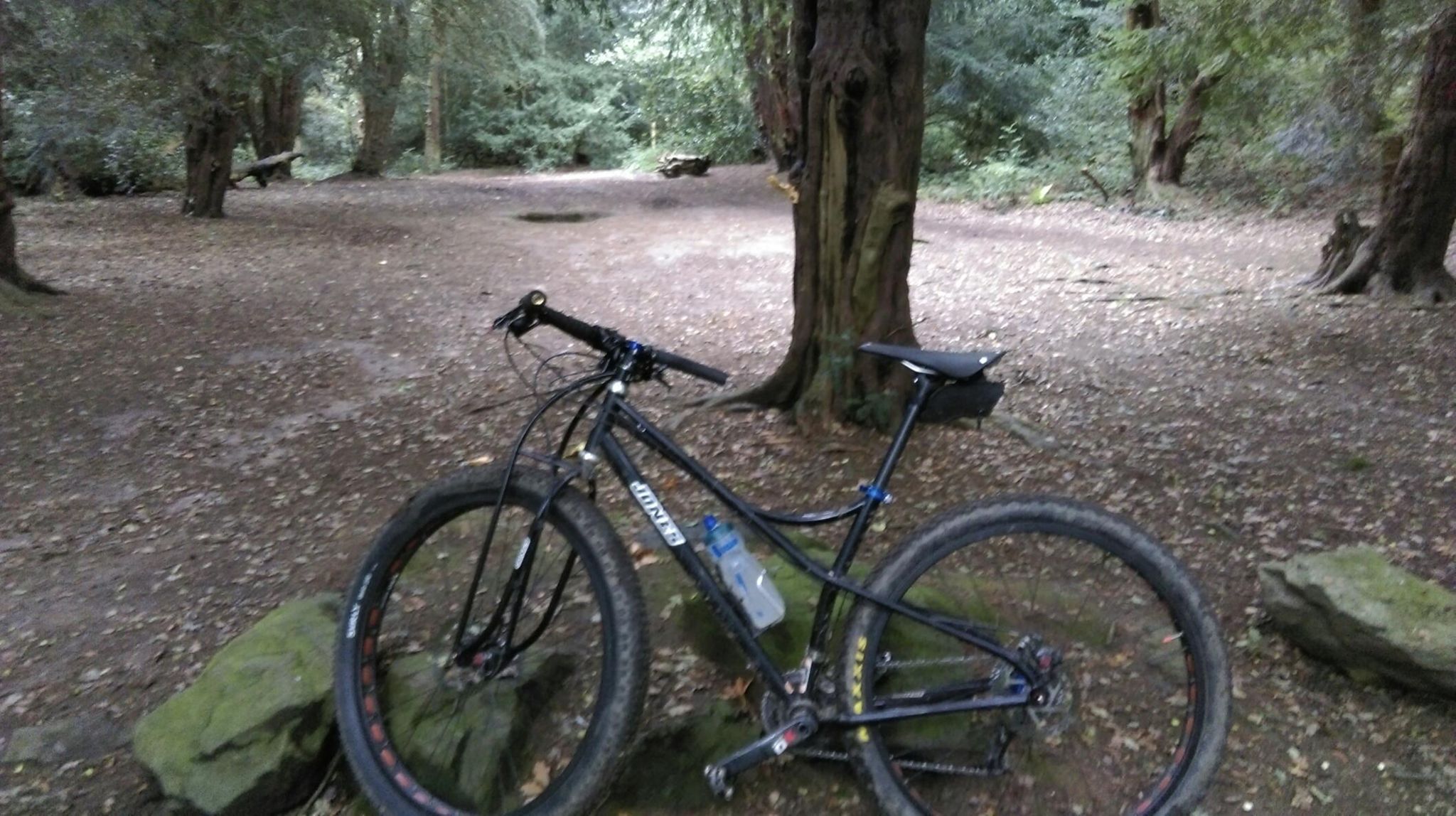

No photos? Shocking.
Here you go
29 x 3 inch knard on the front and a 29 x 2.4 ardent at the back.
As anyone tried a fat front with a B plus rear on their Jones? I have been thinking about it but worried it will be crap.
