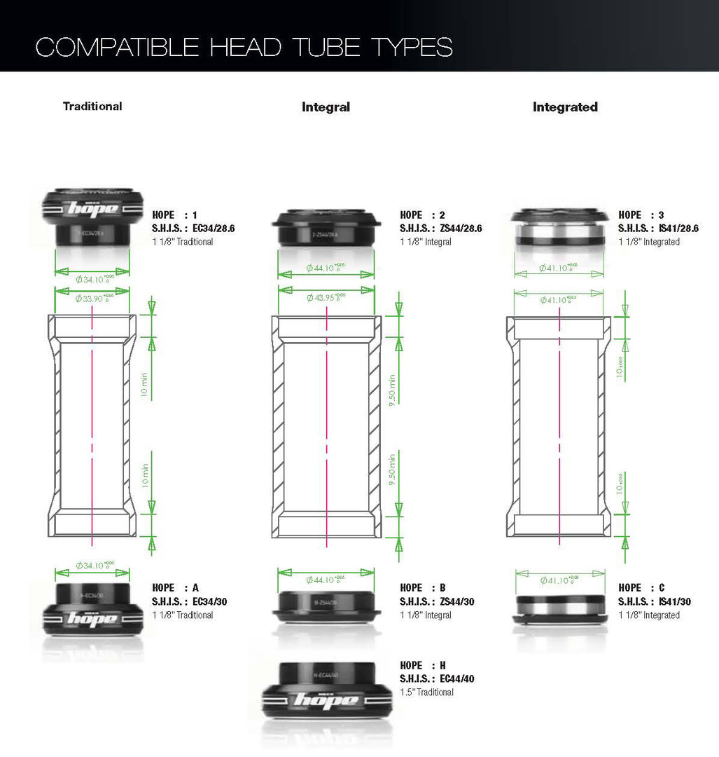

you can fit a 1.5 lower into a 44mm headtube like in this diagram

if it's like this:
then it looks like it's an internal, integrated headset and you're not going to find anything to fit unfortunately. The Slack-r type slackeriser is for integrated tapered head tubes

There is no way of getting a tapered fork in that headtube.
?? really! I cant believe the fork race just sits on the metal of the headtube? are you sre there isnt an internal cup and bearing in there- pics would help
Most modern-ish road bikes have integrated headsets, there is no cup, the bearing just drops straight into the machined headtube.

I think its a 1.25 at the bottom bearing not 1.1/8. So any standard road disk fork technically fits. Ie the fork from my giant defy fits just fine, the issue is that it's completely wrong for the geometry of the bike

Those adapters are shims for fitting smaller forks to larger headtubes...I have the opposite issue, the fork is too wide to fit a bearing in the headtube
Internal diameter of head tube is 47mm. Base of fork is 40mm. So I'd need a bearing that only took up 3.5mm of space either side. Which I assume doesn't exist

You'd need an external bottom cup to replace the internal one. Whether you can buy one off-the-shelf will depend on the exact details of your headtube, but you're probably out of luck on that. A standard 44 mm headtube with an internal bearing can take a 1.5" external cup.

But mine has an integrated headset.  So you couldn't push in an External cup in unless the lip is less than about 5 mm
