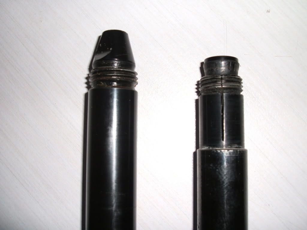

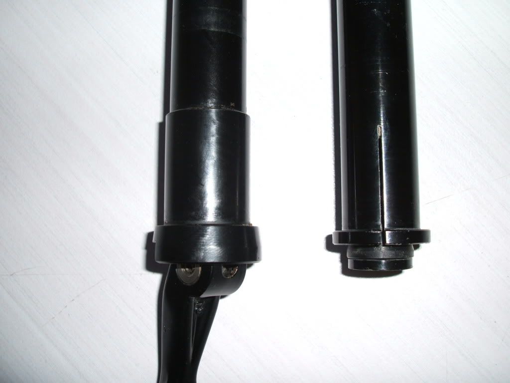

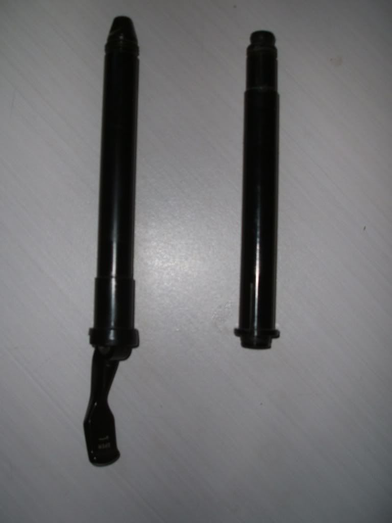

Ok I have looked at both axles am I'm afraid there's no way you can use a QR20 axle in a bolt thru fork.
In the centre section both are 20mm, but on the QR axle, about 20mm from the lever end there is a step up to 22mm, meaning there's no way it will go all the way into a non-QR fork. In addition to this on the standard bolt thru design there is a step down to about 18mm at around 20mm from the thread end. The QR one is 20mm all the way to the thread, so it isn't going to fit in the non-QR thread end either.
Here are some pics I took:
Sorry to be the bearer of bad news, but I hope that clears it up for you at least.
Ade
