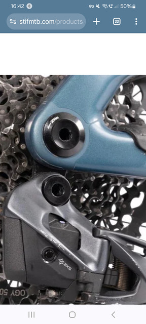

 bens
Posts: 724
This picture looks like there should be a collar on the outside of the thready bit
Screenshot-20240928-164234-Chrome
Picture from Stif
Posted : 28/09/2024 4:46 pm
 bens
Posts: 724
Also from Stif, this dropout is apparently for a Juliana and is definitely threaded
