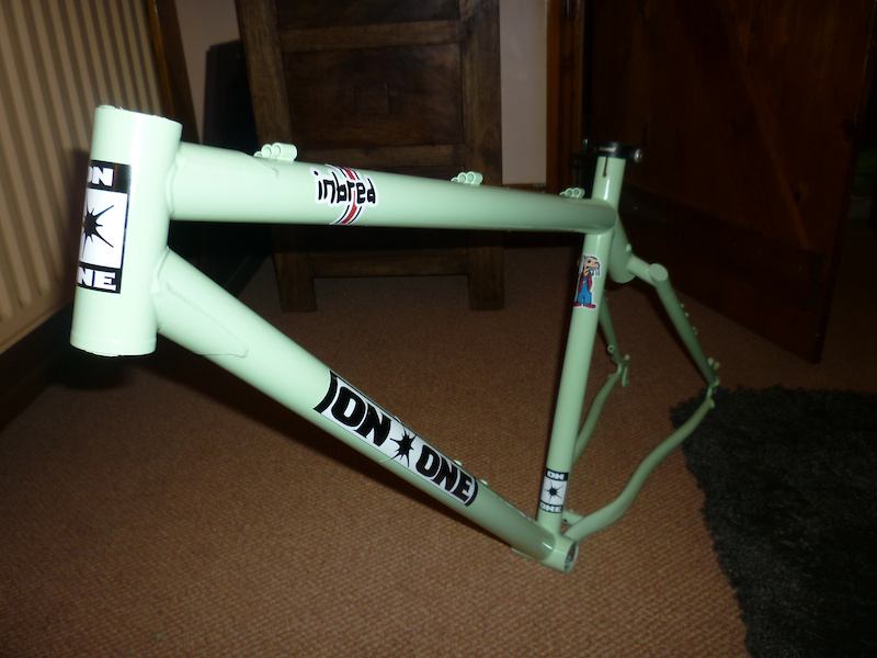

Someone has commented on my new (to me) frame on Pinkbike:
First: something like "you know that's a 456 right?" when I asked what he meant he said: "The top tube on the 456 meets the seat tube in the same place as the seatstays, on the inbred, the TT is slightly lower. For some reason, the early 456's were badged as inbreds (not quite sure why, i think they were known as an "inbred 455" or something)."
I've looked at a few pics and can see what he means - so is he right??

Yep. 456. Top of top tube cable routing and the colour are dead give aways. That's the best 456 colour ever too! 🙂

From memory doesn't the 456 have the same diameter top and down tube?
Posted : 06/10/2011 8:00 pm
Posts: 3384
That's a 456 - you can tell by the pipework being matching sizes.
Yup!

Repainted RAL 6019
[[img] [/img]
Pretty close to the original I reckon

Stickers on
[img][/img]

Yeah, top tube and seatstay intersect at same point on seat tube is a 456, Seat stay higher than top tube is Inbred

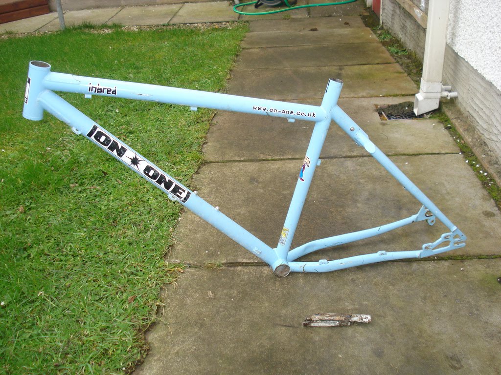

Posts: 3384
what frame is this then....
Posted : 07/10/2011 8:23 pm
Posts: 19914
Barry, yep, that's a normal Inbred. Cable guides UNDER the top tube. 🙂
