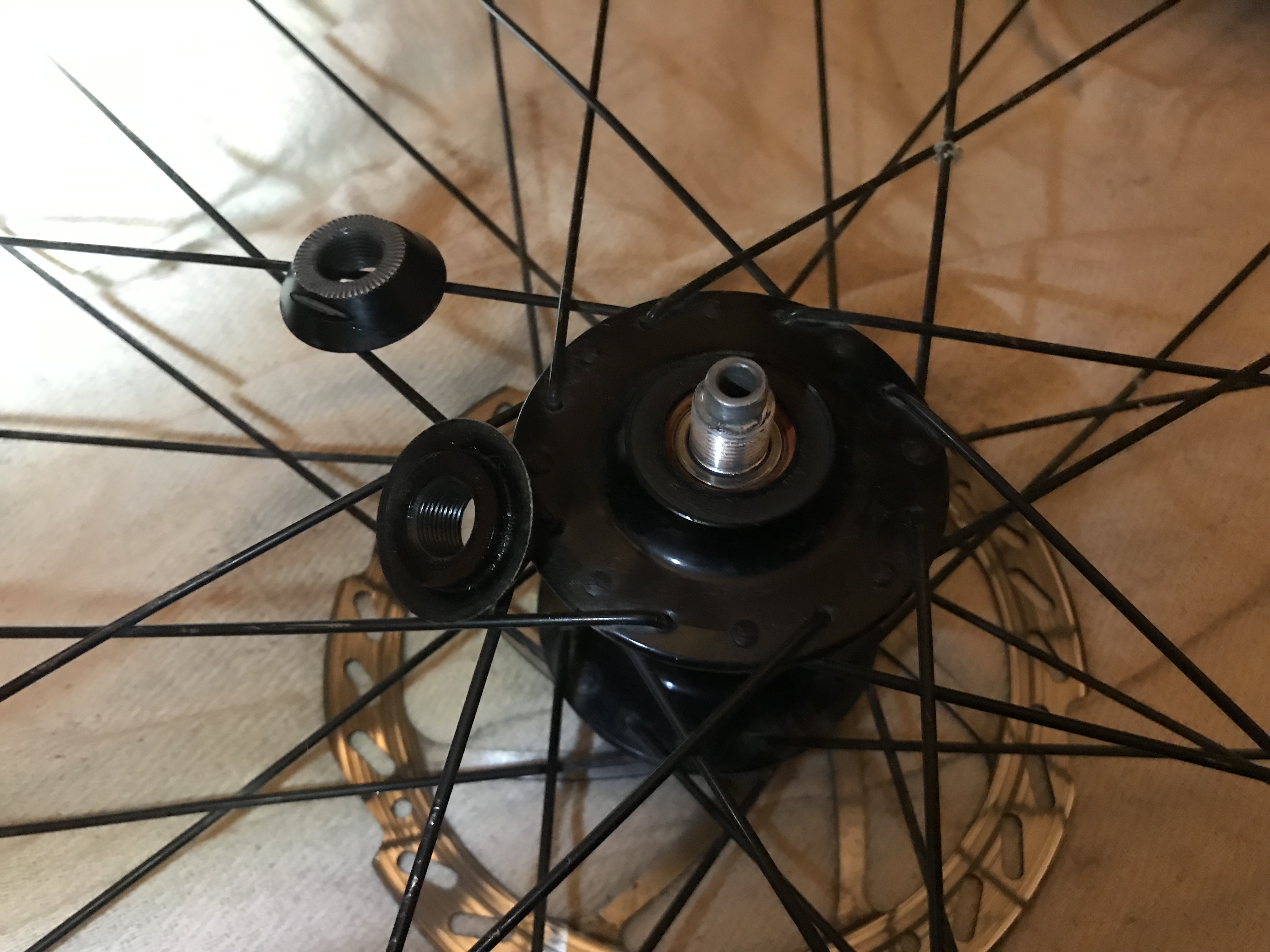

Go easy please folks, I know I’m a QR man from the 90s/00s, yet not so much ‘resistant to change’ as ‘all at sea’ after enforced spell away 😀
OK this is what I have - (no idea of hub brand/type as it came laced onto a used TD24 rim, have removed QR skewer obv)

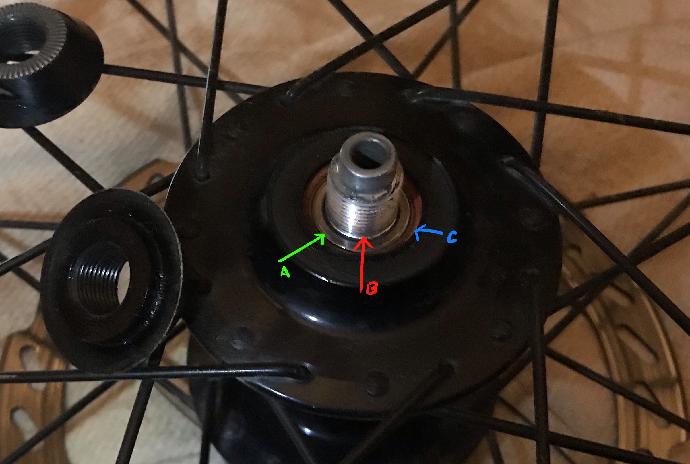

I would say no, but what is the diameter if the axle/inside of the bearing?
A 15mm axle may fit, but you'd also need end caps.

Where am I measuring? (I did warn you 😆)

You need to measure the outer diameter of the bearing then see if you can find a bearing with the same outer dia. and 15mm inner dia.
Edit: just seen photo, measure B first and report back.
Thanks Jordan. Ok, not having calipers I used a fairly solid set of adjustable grips on the threaded axle and get 12mm maybe 12.5mm
Posted : 26/09/2019 8:55 pm
It's nice to measure all that stuff but I think the fact is if you can't id the hubs you have, you have little chance of getting what you'll need to make them fit. I'd start by trying to figure out what they are.
Posted : 26/09/2019 9:20 pm

tbh it's not going to be simple without knowing what hub it is and seeing if a kit is available unless you're into a bit of engineering/bodging. You will need to strip the hub out first and see if there are the neccessary clearances in there to get in what you need to get in.
First job is sourcing some bearings as I said above, so you'll need to get the old bearings out and do some measuring. I sourced some from www.simplybearings.co.uk
Bear in mind, I haven't actually done this yet so this is all theoretical. I am working from the DT Swiss 370 parts diagram which tells me most of what I need to know about my hub and I have some engineering skills. Then you'll need to souce/fabricate a spacer to go between the bearings. Then you will need to source/fabricate some end caps.
Sourcing the correct spacer and end caps won't be easy since most manufacturers don't publish dimensions.
If you know how to use a lathe it will help enormously.
