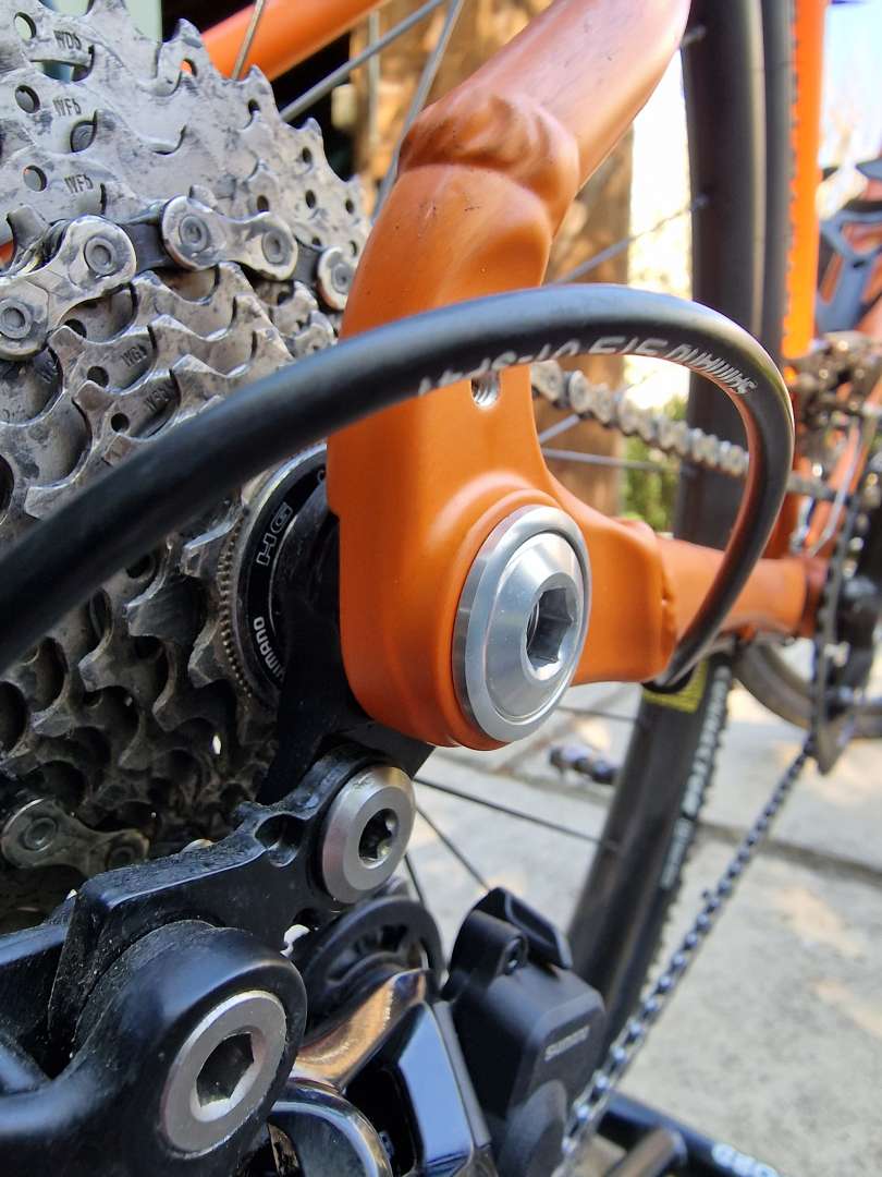

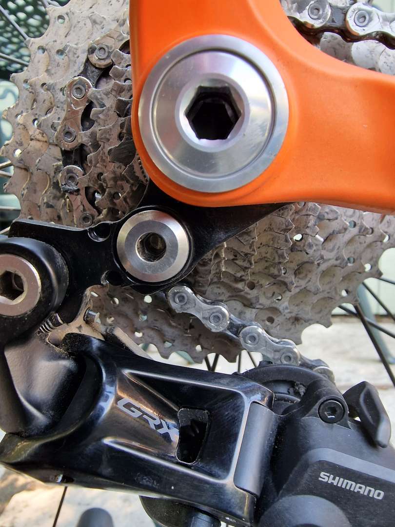

I usually keep a spare hanger in my bag just in case. Got a new Boardman ADV, is this UDH? Doesn't have any markings on it saying so, and the specs don't mention the hanger.

If you undo the silver bit is that the axle? If so I don’t think it’s UDH as the axle goes in from the non drive side for UDH.
So if it goes in from NDS it might be UDH.
i think.

Hard to be sure but it looks likely its UDH.

That doesn't look like a UDH. If it  is it will unscrew with a left hand thread and have 2 parts to it.

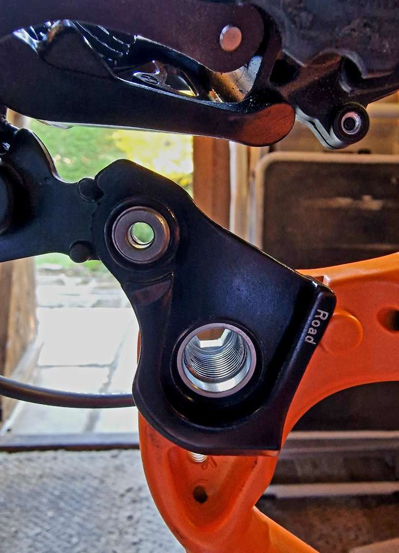

Don't think so. No bolts, it's held together by the big silver bolt. The axle bolts in from the other side. Says 'Road' on it, I notice. Never had UDH before, assume it is one after a Google of pics of UDH hangers.

Its not a SRAM hanger, but that is UDH - Or at least if its not, its such a close copy you'd wonder why they didn't just make it UDH..
