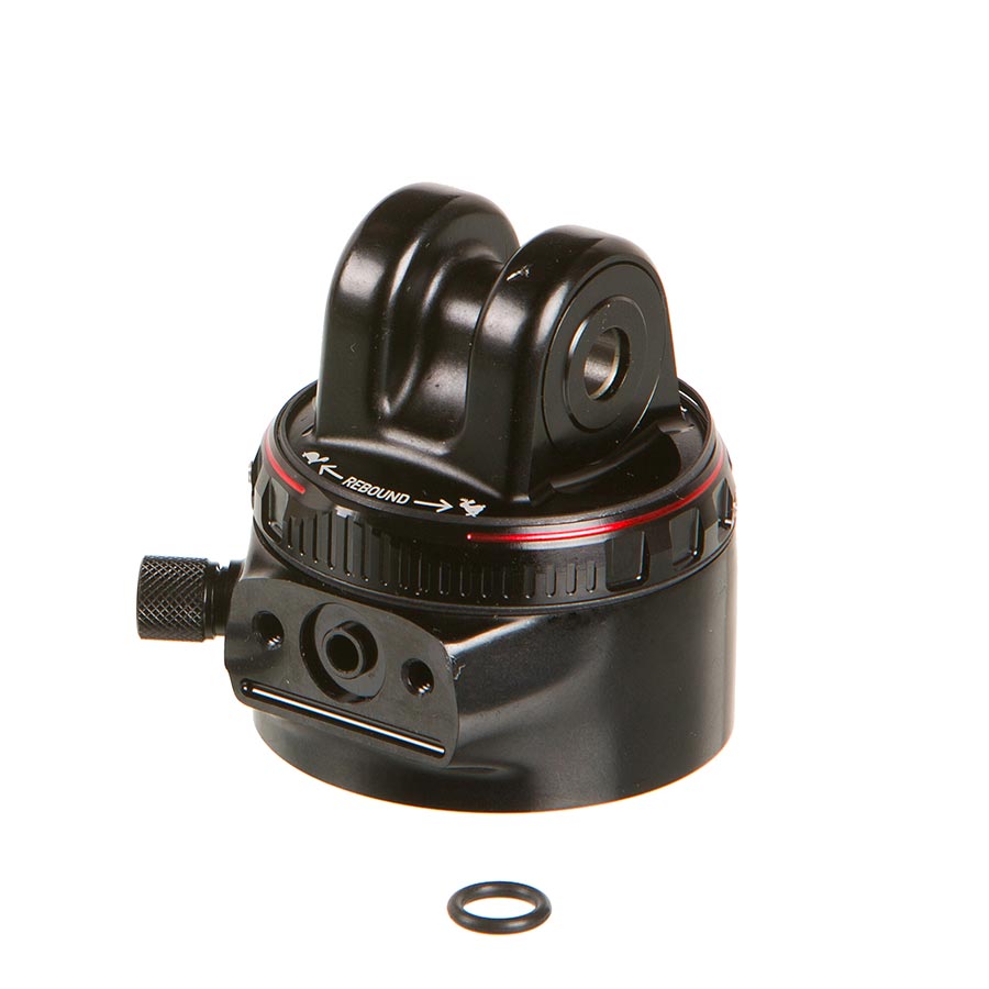

We've had an interesting week up to now.
The boy has been riding with a bunch of mates (well they are now) including 2 junior WC racers. It's been an absolute blast it seems.
We had another shock bushings issue which is really irritating me now, so I've been chatting with Ruth at TFTUNED on thoughts, we've got a few things to try when back. But chatting to others in paddock, this isn't uncommon on Sessions
So what we've done for now is fit what was at the time a brand new shock, it was taken off a new 24, it has a completely different mount with a big housing and bearing top end. It's been golden for 3 days now

Posts: 2571
We had another shock bushings issue which is really irritating me now, so I’ve been chatting with Ruth at TFTUNED on thoughts, we’ve got a few things to try when back. But chatting to others in paddock, this isn’t uncommon on Sessions
So what we’ve done for now is fit what was at the time a brand new shock, it was taken off a new 24, it has a completely different mount with a big housing and bearing top end. It’s been golden for 3 days now
Chewing through shock bushings?
Loading them up on one side?
Or just going slack ?
Run one of these on my kenevo Sl (geometron is sphericals both ends) to protect the shock from side loading.
https://dhsign.it/en/14-fixshox-classic
Posted : 19/08/2024 10:25 am
weeksy and weeksy reacted
Just going slack and a tiny bit of wiggle/play.
Apparently it's a 'thing' on these.
The 24 uses a bearing mount top which we've now got fitted, but his 23 shock is more adjustable and setup so we'd ideally like to run that.
We have a couple of options with TFTUNED on this, chatting to Ruth they can check the eyelet size and make a 30mm spacer of a fractionally bigger diameter to compensate for it.
Or there's
https://www.tftuned.com/fox-shock-mounting-hardware-bearing-roller-full-complement-8x30mm/p3730
Which could replace top mount with bearing mount, again this would help/solve (hopefully)
Short term, he'll run the 24 shock which after 4 days hammering was still sweet.
We've had times where the bushing lasts a month or two, but Sunday of race day it lasted 24 hours lol. Chatting to others in various paddocks it's a fairly common thing, which I think is why they fitted the bearing shock in the 24 models.
The boy is still sleeping so I've been sorting the Status 160 this morning and waiting for him to get up and fed and we'll start on his Session. It was checked every day sk I don't think there'll be anything to fix, but I'd like to go through all the bearings and see how his pads are etc.
Posted : 19/08/2024 10:46 am

The rotation on that top shock eye is pretty big and the forces its dealing with are high. Is the hardware wearing as well, or just the bushing?
Posted : 19/08/2024 11:03 am
That's the $64,000 question. To me one of the spacers I removed looks pretty polished, so I'm guessing that's a bit worn.
I replaced that with a new spacer and bushing, but like I say it developed play in 24 hours. So maybe a fractionally bigger spacer would be the answer.
I'm not massively concerned as it's a quick fix, but obviously I'd prefer months rather than hours between swaps

I'm running one of those Fox bearing mounts (not on a Session), they work well and are much better than bushings IMO and easier to fit

It's been kind of an irritating time at the moment. The hand from Morzine still isn't 100% so i've basically been a van driver for the lad in the last week rather than a rider. He was at Rogate with mates on Sunday and then yesterday was Ponty with another mate. So he's getting plenty of time in on the bike, he's out on Weds with Katy and then we're off racing again this weekend.
Which brings us nicely back onto the Trek Session.
If you recall we've been blowing through shock bushings in a fairly alarming rate at times. So the shock was sent off to the lovely people at TFTuned who're supporting him and the team this year thanks to Ruth and Katy.
Just been chatting with the Tech Guy Mike about his shock and sadly it's seen better days, the shock body is damaged and marked up a bit more than they'd usually be happy with. Sadly the part is due "next year" lol. So they don't have a spare lying about either. It'll get put back together and after a fair bit of discussion on options the shock will end up at the spare.
His current shock is off a 2024 Session from a mate which we bought as a spare.
https://northwestbicycle.com/products/rockshox-super-deluxe-r-eyelet-assembly-bearing-eyelet-11-4118-073-002-h942777-01
This shows the top mount, rather than the standard bushing/spacer. It's thought of as being far more durable (especially with LLUMax bearings installed).
The standard shock is showing wear on the eyelet, so the recommendation from TFTuned is to keep the 23 shock as the spare and run the later 24 model as the everyday shock. Apart from the fact that we've used a little bit of 'mmmmm' and 'hows' that?' to get it setup, there's no real downside to this shock, but it does mean we may now have a bit of a play with this.  Of course TFTuned could dial that one in for us, but that means getting it out of the bike and off to them, which as we've got some racing coming up for a few weekends means we'll just have to wing it for now.
Posted : 27/08/2024 1:05 pm
