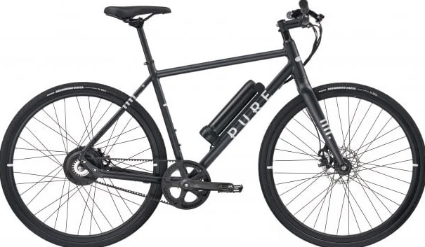

I enjoy the Pure Flux
single speed e-bike
it’s perfectly fine to call it cheating, won’t diminish the smile on my face
carbon gates belt means brilliantly all round low maintenance
