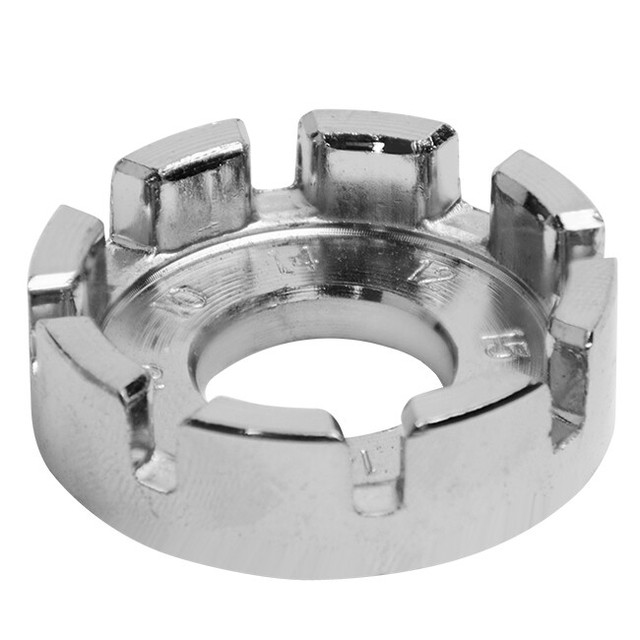

I usually use one of these ... fits exactly and has the benefit of also tightening spokes
I've a bunch of DT Swiss type ones in my toolbox (lid) with spare valves and spare cores but this is my go-to in the toolbox. (I also have other spoke keys ... wouldn't use this for a whole build but again its just easy to keep handy)

£2 for a multi-spoke key and £4 for a pack of 10 valve cores ... spray with silicon and leave in tool box... when you top up remove old one... wash in warm water and fairy ... dry..spray with silicon and replace the one you took from the toolbox.

Good advice 👆🏼Spoke key here too, slot 11 👍🏼.Got a stash of 100ml syringes(unused) from a derilict Pit infirmary
