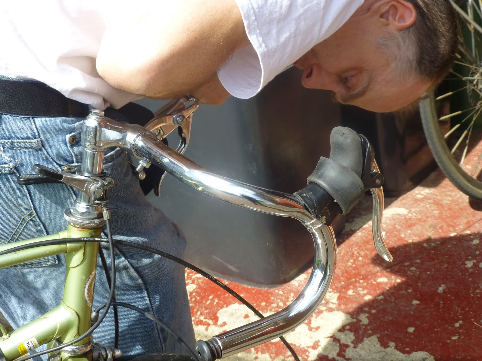

"The loops are for the gear cable outers from the STIs. The braze ons are for the bolt on barrel adjusters. Or you can use it with down tube levers."
It's a bit odd, because those braze-ones are neither threaded nor stopped, and might possibly be for adapters as thisisnotaspoon suggests. I'm wondering if they might actually be for full-length cables to the mechs*, and if the plastic guide isn't original? Surely they'd be a bit pointless if using downtube STI adapters?
And if it actually is a 'late '80s' bike, then it wouldn't have any STI related braze ons anyway. Plus more likely to have a 126mm rear dropout spacing I think, rather than 130mm.
* For use with stem-mounted shifters:
Posted : 12/10/2016 11:10 am
They only take the outer to prevent cable rub, it's not an end stop. That's why they have no thread or anything. They probably aren't strong enough to take a barrel adjuster of any sort either. Not without bending or dropping off after 3 months. That's what the other bosses are there for. STi was launched in 1990. So late 80s/early 90s matches.
It's also a fairly decent frame and is *unlikely* to have used stem mounted levers. Another possibility is that it's custom and the owner has used bar end shifters. There were still a few guys doing that late 80s/early 90s. Much less common after the mid 90s. When STI type shifters were everywhere.
Posted : 12/10/2016 11:36 am
